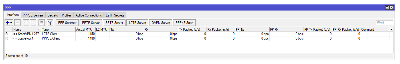

1 - created L2TP connection - its connected - OK

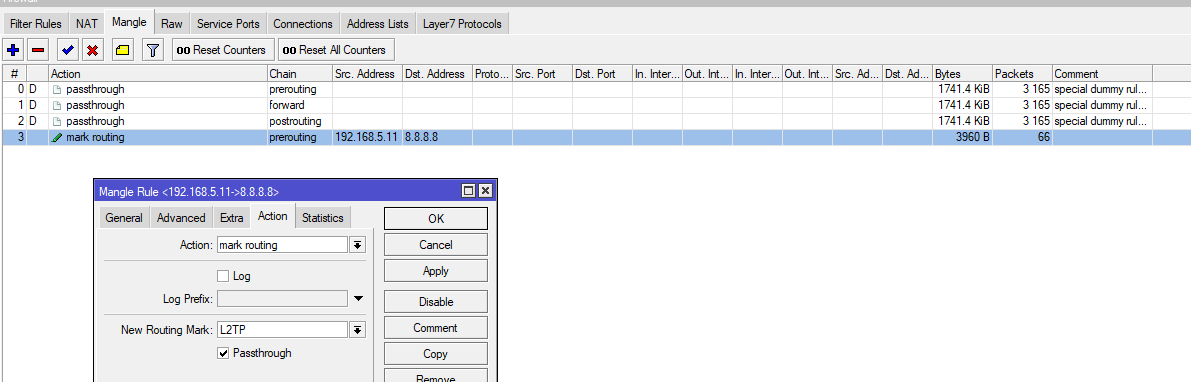

2 - I created mark routing mangle from local IP to destination 8.8.8.8. If I ping 8.8.8.8, packets count is increasing - OK

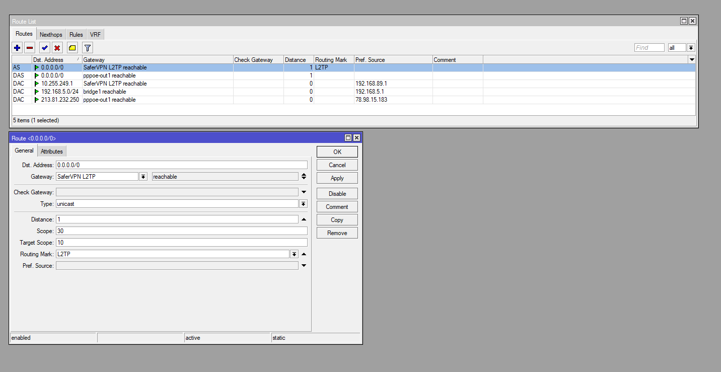

4 - until this point ping to 8.8.8.8 is working. Immediatelly when I add this static route , ping will fail.
I have tried to disable all firewall rules, but nothing helps me. I do not understand it , please help me !!

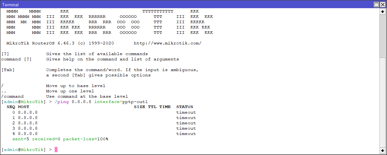

update : it seems that this is some kind of problem with VPN interface itself , or there is something with routing tables as I cant even send ping from router itself - packet gets lost ?
