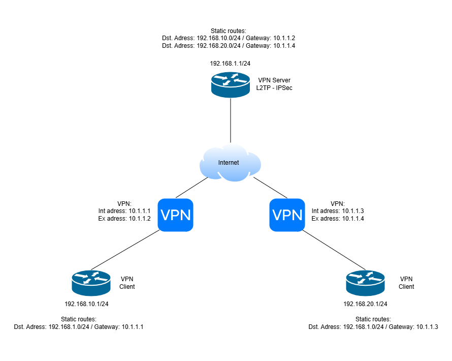

I’m new to routing and mikrotik and i need some help, hope you can help med out
Just bring questions if there is something you need to know
I have made up a solution with 3 mikrotiks where one of them i set up as L2TP server with static WAN
and there is 2 that acts as clients with dynamic WAN
I have managed to make static routes so 192.168.1.x can reach 192.168.10.x and 192.168.20.x and this workes fine.
But i don’t manage to get connection between 192.168.10.x - 192.168.20.x networks
Example: I need the host of 192.168.10.20 to connect to host of 192.168.20.20
Can you maybe help me out? Sorry for my bad knowledge
Best Regards
Mattias
No need to be sorry for “bad knowledge” - everyone has to start from somewhere after all
As for the routes, luckily it’s quite easy to set them up - on the 10.1 router you add a route that points to 20.1 with gateway the VPN and vice versa:
# 192.168.10.x router
add dst-address=192.168.20.0/24 gateway=10.1.1.1
# 192.168.20.x router
add dst-address=192.168.10.0/24 gateway=10.1.1.3

Thanks for the answer!
I tested that yesterday and it didn’t work out
But i played around a bit and found a solution that is working. I don’t know if it’s right but maybe you can sort that out for me!
add dst-address=10.1.1.0/24 gateway=10.1.1.1
add dst-address=10.1.1.0/24 gateway=10.1.1.3
If the solution is the one you posted under the quote, it’s the right one and the same as mine. I missed to mention that the routes I posted are additional to the ones that were to be seen on the network diagram

Yes i needed to add:
add dst-address=10.1.1.0/24 gateway=10.1.1.1 - on router 2
add dst-address=10.1.1.0/24 gateway=10.1.1.3 - on router 3
I thought that 10.1.1.1/10.1.1.2 was aware of 10.1.1.3/10.1.1.4 but it was not the case
so the route of 10.1.1.0/24 made that happend
Do you think this is the right way or is there a easier way?
Best Regards
Mattias
Now that I think about it, the routes really are a bit odd… Would you mind posting an exported config of the VPN server as well as at least one of the clients?
export file=anynameyouwish (minus sensitive info like serial numbers, public IPs, etc.)

Just so you know remote router R3 has 192.168.30.0/24 instead of 192.168.20.0/24 like in the diagram, but i don’t think that makes som difference

It’s because of the local address of the PPP secrets on the L2TP server - if you set it to be one and the same for both secrets (say 10.1.1.1), then there should be no need for the two routes. I don’t expect it to make problems the way it is, so if you don’t mind the routes, you can leave it as it is

Config i set to routers:
#R1
add local-address=10.1.1.1 name=L2TP-R2 password= profile=\
remote-address=10.1.1.2 service=l2tp
add local-address=10.1.1.1 name=L2TP-R3 password= profile=\
remote-address=10.1.1.3 service=l2tp
#R2
add comment="Route till R3 192.168.30.0/24" distance=1 dst-address=\
192.168.30.0/24 gateway=10.1.1.1
#R3
add comment="Route till R2 192.168.10.0/24" distance=1 dst-address=\
192.168.10.0/24 gateway=10.1.1.1
Hello, tried that out but i didn’t work out. Still needed to add:
in both R2 and R3 to make it work
It’s not a problem and i still manage it to work
Just funny to know why thing happens for a reason so i can learn from it and troubleshoot in the future
