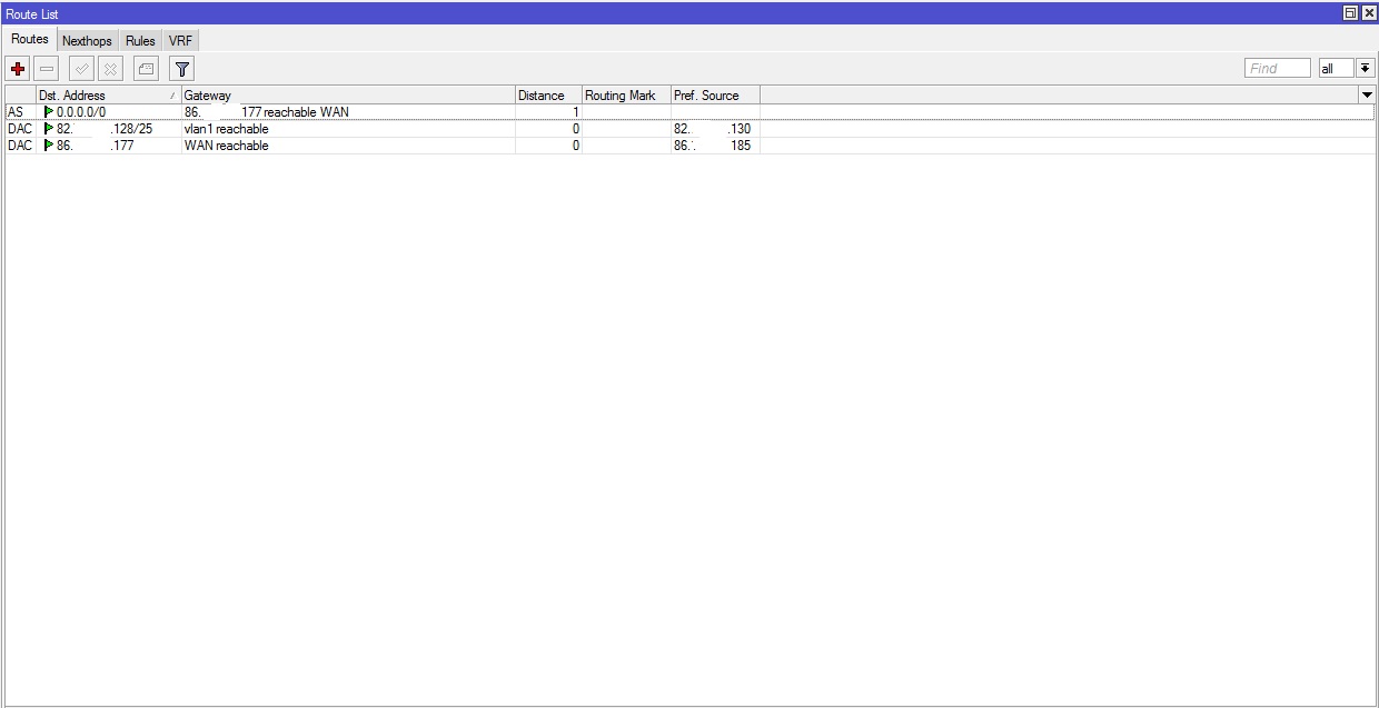

I have routing problem, my ISP routed to my MT a subnet 82.xx.xx.128/25 IPv4 public throught a public IP ( 86.xx.xx.185/27 ).
For aprx. 12 moths the RB worked well with these settings:
Routing table:
Flags: X - disabled, A - active, D - dynamic, C - connect, S - static, r - rip, b - bgp, o - ospf, m - mme, B - blackhole, U - unreachable, P - prohibit
DST-ADDRESS PREF-SRC GATEWAY DISTANCE
0 A S 0.0.0.0/0 86.xx.xx.177 1
1 ADC 82.xx.xx.128/25 82.xx.xx.130 vlan1 0
2 ADC 86.xx.xx.177/32 86.xx.xx.185 WAN 0
Detaile:
0 A S dst-address=0.0.0.0/0 gateway=86.xx.xx.177 gateway-status=86.xx.xx.177 reachable via WAN distance=1 scope=30 target-scope=10
1 ADC dst-address=82.xx.xx.128/25 pref-src=82.xx.xx.130 gateway=vlan1 gateway-status=vlan1 reachable distance=0 scope=10
2 ADC dst-address=86.xx.xx.177/32 pref-src=86.xx.xx.185 gateway=WAN gateway-status=WAN reachable distance=0 scope=10
vlan1 = eth1 = 82.xx.xx.130 (this is the gateway that i want to use in my public subnet) , vlan1 = eth1 = eth2 = eth3 - Bridged (Routerboard 450G with v5.14 )
WAN = eth0 = 86.xx.xx.185 ( this is the public IP from WAN port - that faced the ISP )
They said that from their side all it's o.k and nothig was changed (don't think so) i tested and tested with diferent configuration but no results. Know i use masquarading as a standby solution. Please help!
Best Regards!
Vlad
Can you check the IP addresses allocated to your interfaces (and perhaps show the output/configuration here)?
From your description, I would have expected the above to be:
2 ADC 86.xx.xx.160/27 86.xx.xx.185 WAN 0
I imagine you cannot currently ping 86.x.x.177 from the router either?

So shouldn’t your WAN interface be 86.x.x.185/27, not 86.x.x.185/32 ?
Regards,
It is /32 because it's the ISP interface(WAN) and i have just 1 (one) ip from the 86.x.x.176/28 (sorry it's not /27 it's /28) that's why i have 86.x.x.185/32 and even i modfy this it doesen't work:
ADDRESS NETWORK INTERFACE
0 ;;; default configuration
82.77.199.130/25 82.77.199.128 eth1
1 86.120.31.185/28 86.120.31.176 WAN
I set it as /28 ( subnetmask is: 255.255.255.240) but it's not working. :frowning:
Best regards,
Vlad
Based on the information you’ve given so far, it sounds to me like it should be /28, not /32, otherwise your device will not have a route to get to 86.x.x.177.
Okay, now you have provided the actual IP addresses involved, I would say that there is a problem with your providers configuration, as I can trace a route to your WAN IP, but not to your /25 allocation - the traffic seems to stop as your providers border, suggesting that their do not have a route for your /25 in their internal routing table.

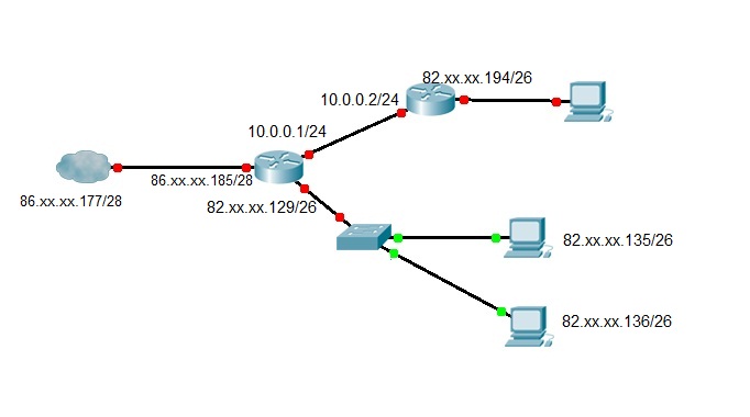

I'm back with another problem , i bought an new MT and want to re-route a subnet(/28) from my entire subnet(/25).
Here's my configuration on first (central MT) where is the problem:
0 A S 0.0.0.0/0 86.120.31.177 1
1 ADC 10.0.0.0/24 10.0.0.1 eth1 0
2 ADC 82.77.199.128/26 82.77.199.130 vlan1 0
3 A S 82.77.199.208/28 10.0.0.1 10.0.0.2 2
4 ADC 86.120.31.176/28 86.120.31.185 WAN 0In the file attached it can be seen what i am doing...
I can ping the 82.xx.xx.209 interface from internet , but from the second MT i can't ping the internet through the 82.xx.xx.209 interface :frowning: somthing is not right ...also i can ping the 86.120.31.185 (WAN from first MT) but the GW of ISP is not responding from the second MT... some ideas?
P.S in the image i have the "82.xx.xx.194/26" it's not right , the right assigned ip is: "82.xx.xx.194/28" just 16 ip's i need pleaning to buy a new MT to make a ring :slight_smile:
Best Regards

Can you show us the routing table on both routers, and just double check the diagram and make sure it is correct/accurate, please?
Regards,
