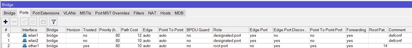

If you want STP protection, then use RSTP over the old STP. I would choose 1st ac as root bridge (setting RSTP priority from 8000 to 6000). See if 2nd ac shows the port to this root bridge then, and look at how the bridge ports signal what they are “edge” , “discover edge”, “point to point”. Interesting as the WLAN with only clients should be “edge” , and the WLAN that links to the 1st ac I expect to be “not edge” but “point to point”. There is no ‘map’ of the spanning tree.
Interesting to watch and learn. Things change when there are devices connected to the WLAN or not. But I don’t understand why in my ethernet connected wAP ac with only clients, the status for “edge port discovery” is different for the default WLAN1 and WLAN2. “edge ports” up/down will not generate topology changes in the spanning tree.
