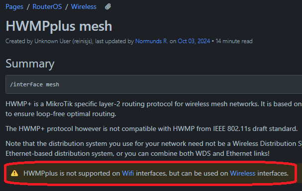

I would like to know as well. I read in the online documentation that wifi-qcom does NOT support mesh, and therefore, this may be my only option.
https://help.mikrotik.com/docs/spaces/ROS/pages/8978441/HWMPplus+mesh
