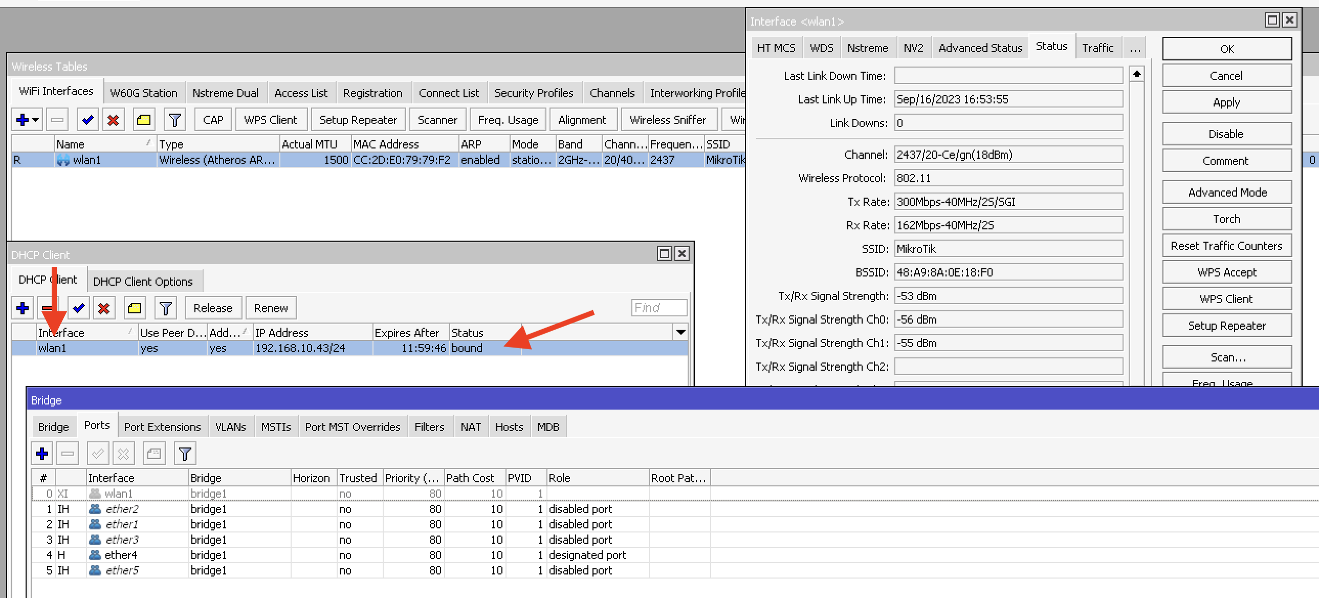

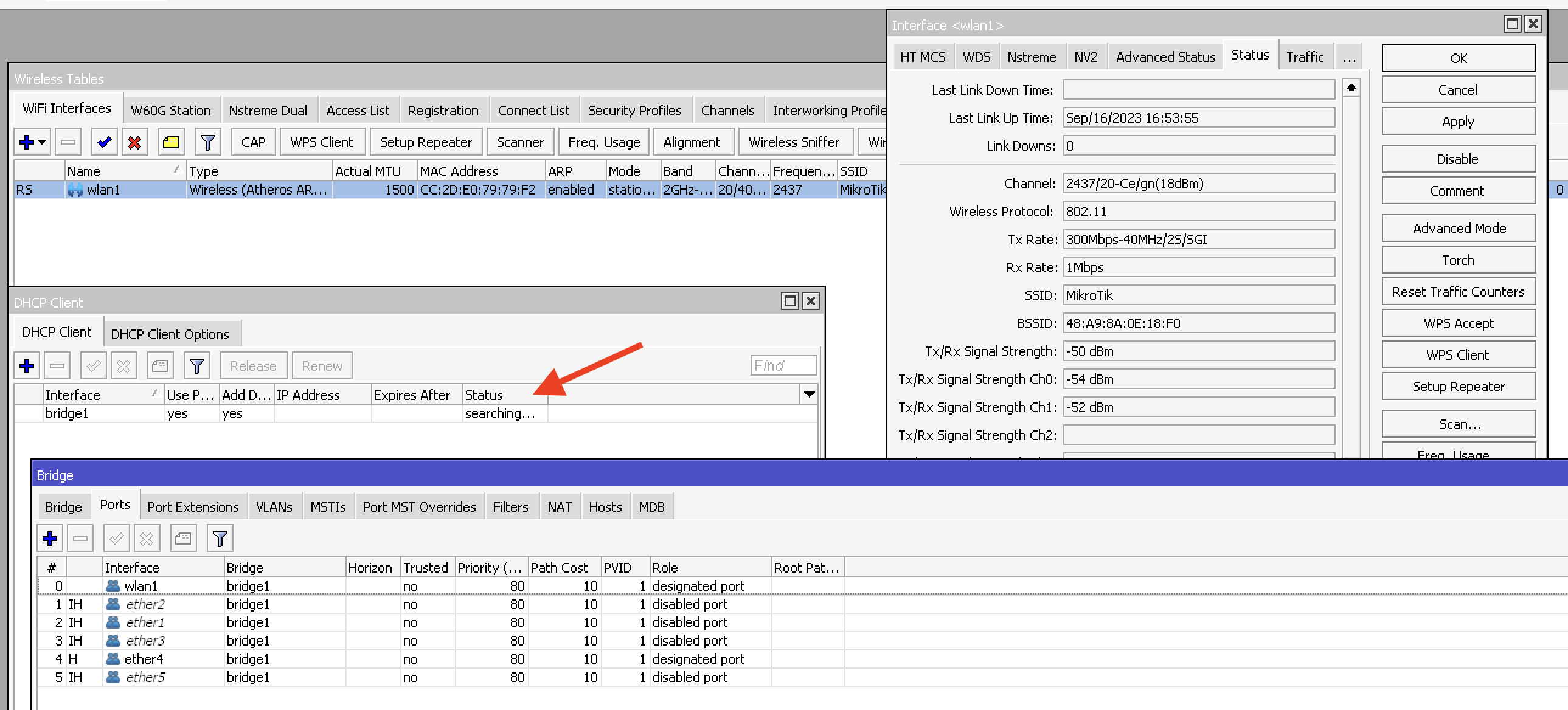

wifi1 is connected but there is no traffic and the dhcp client doesn’t get an IP
I’m sure I configured wifi correctly, if I remove wifi interface from the bridge it immediately gets an IP from the hAP ax3
There is something I need to enable in the hAP’s bridge to make station pseudobridge mode work with another MikroTik?

I thought of a bridge configuration problem because if I don’t add wlan1 to bridge1 in the hAP I see that data exchange (see first message)

If I remove wifi1 from bridge1 and add it as a dhcp client, wifi1 gets an IP from the router, why?
It doesn’t seem like a problem with wifi compatibility…
