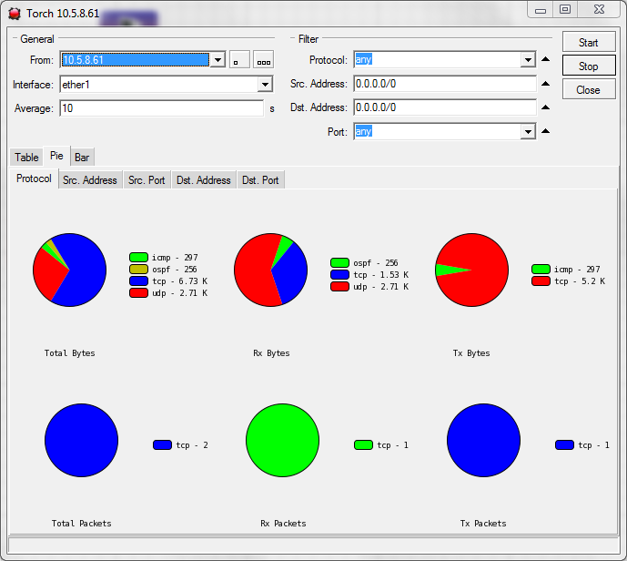

You can use the Torch to see traffic types.
The Dude does nice job with the Torch:

This will already help a lot, thank you.
Ekkas
Edit: This will work just fine, I just set the seconds to 60 or so and already see the trends I was expecting.
