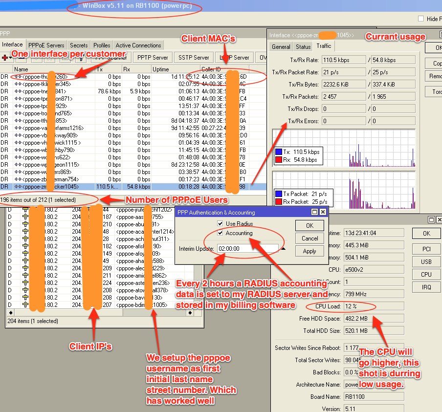

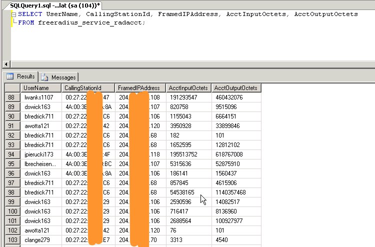

Hopefully the two attached screenshot will help answer your questions… One is a screenshot of some interesting data from my database and the other is some interesting info from one of my RB1100’s

I am very happy that we went with PPPoE. It allows me to manage the users speed, gather usage data and aids in troubleshooting connections. Also, many billing systems can be easily configured to display or bill based upon usage from the PPPoE connection and I have experienced that the PPPoE is a great fit for usage information, simple troubleshooting, IP consolidation, and central management. We have even seen improvements in throughput of our nearly overloaded AP’s due to centralization of QOS settings etc which is more due to consistency across the network then to some inherent value of PPPoE. When I have a larger tower I use a PPPoE concentrator (ie local router) and a distribution router at that facility (generally an RB1200). With smaller towers I use one router either a RB1200 or a RB493AH. You could also use multiple PPPoE concentrators on one if you wanted to but I would probably just find something with enough CPU power to handle the load. I do not regret converting our network to using PPPoE… We are at the tail end of converting about 3000 connections to PPPoE.

I use FreeRADIUS and have it setup with both MySQL and MSSQL (freeradius, freeradius-iodbc, & freeradius-mysql debian packages)
You may not need the MSSQL connector but our billing system runs on MSSQL so this was necessary for us. Another approach would be to write to the MySQL database from your billing software when records are changed… basically to do MySQL inserts to update usernames, passwords, speed plans, or assigned IP addresses (statically assigned).
Then in the sql folder, you’ll find dialup.conf files that have the sql update commands. You can modify these as needed to write to the columns you need. Then you will need your billing system to read & write to these records/columns.
As far as db organization for auth, its pretty much a username & password field that are matched against. If it is successful then a radius accept message will be returned. A second part of this is that you can assign groups to the user. The group table is then consulted and all of the attributes for that group will be collected. An example of a group parameter could be: “mikrotik-address-list = gold_package” or “Framed-IP-Address = 1.2.3.4”
