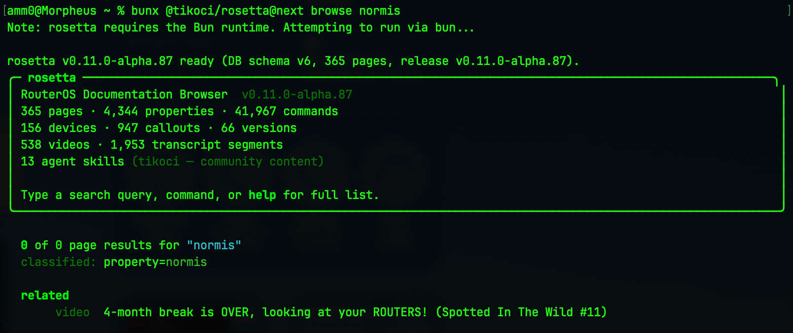

Docusaurus-based Rosetta MCP now available
Rosetta now use the Docusaurus .md files, instead of the Confluence HTML for main help pages in the "testing channel". I have not marked it a "latest", but you can use them by using the next channel, which will always get latest alpha/beta/rc tag. 0.10.x is last version using Confluence, and any 0.11.x+ version use Docusaurus.
Since the Docusaurus version is not be marked as latest yet. To use, just add @next to any of the bunx command lines used MANUAL.md/README.md examples. e.g. bunx @tikoci/rosetta@next instead of the plain bunx @tikoci/rosetta. From a Mac terminal, you can use the non-AI TUI interface using bunx @tikoci/rosetta@next browse ("browse" launches the TUI interface, while without any args, Rosetta launches the MCP Server on stdio)
NOTE For use via HTTP-based MCP Server in a /app container, use ghcr.io/tikoci/rosetta:next as the tag before adding the custom /app, see https://github.com/tikoci/rosetta/blob/main/README.md#install-on-mikrotik-app - changing :latest -> :next before adding the /app.
All seems to work using Docusaurus in automated tests and from some limited manual testing. I'll bump Rosetta MCP to "latest" in npm ... after I use it for a bit. But since only the main doc source changed, and the rest of the catalogs (device/changelog/video/etc) remain the same... but want look for data quality issues and add more tests on that part, since there may side-effect on formatting or links from HTML to Markdown change.

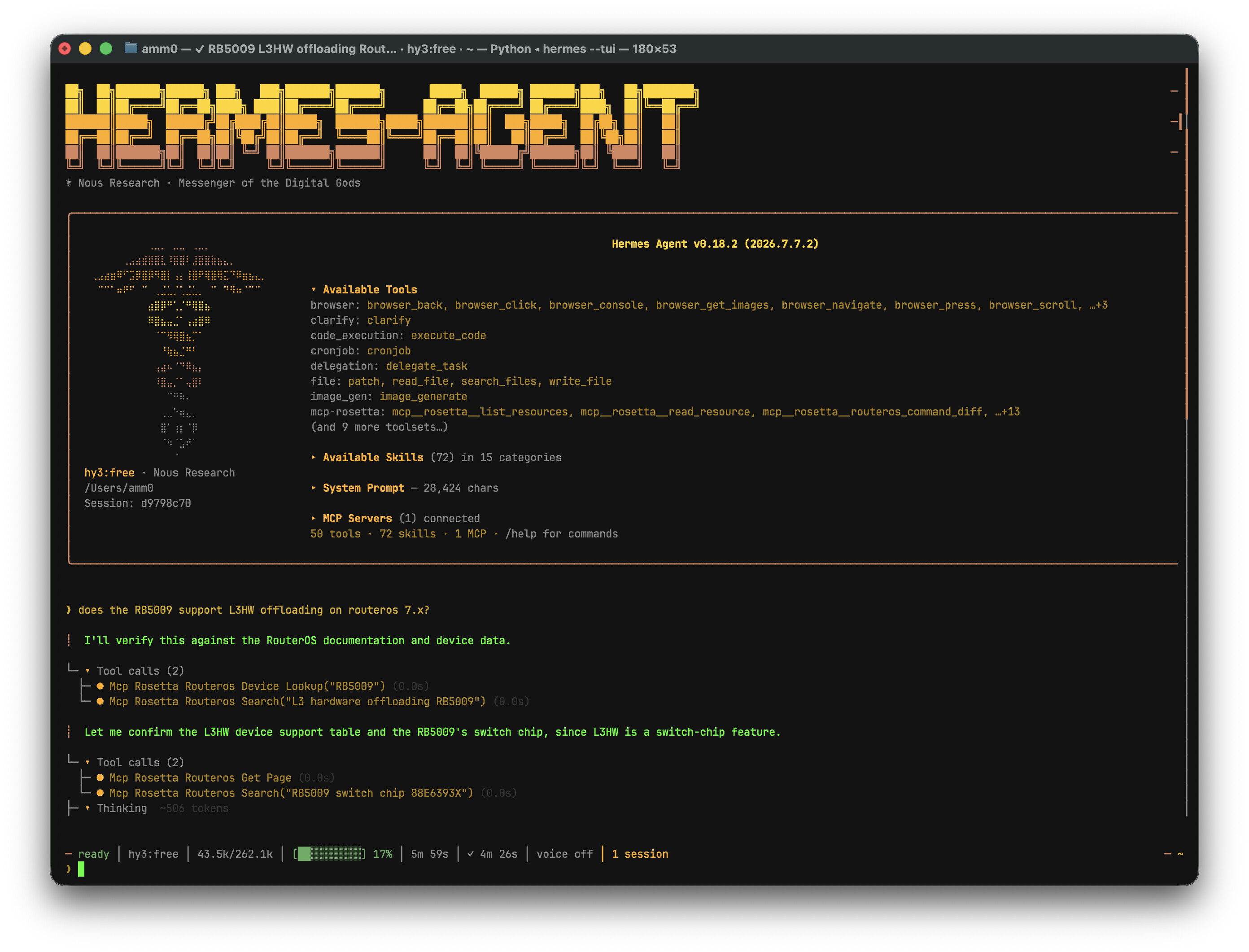

I installed hermes on Mac, and it does work with Rosetta - including the new Docusaurus @next version... For desktop, you add below to the ~/.hermes/config.yaml file (or wherever Hermes says it config file is, and you need bun from https://bun.sh or brew install bun on Mac):
mcp_servers:
  rosetta:
    command: "bunx"
    args: [ "@tikoci/rosetta@next" ]

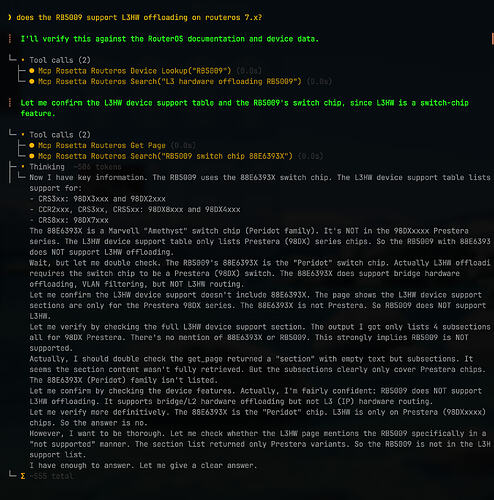

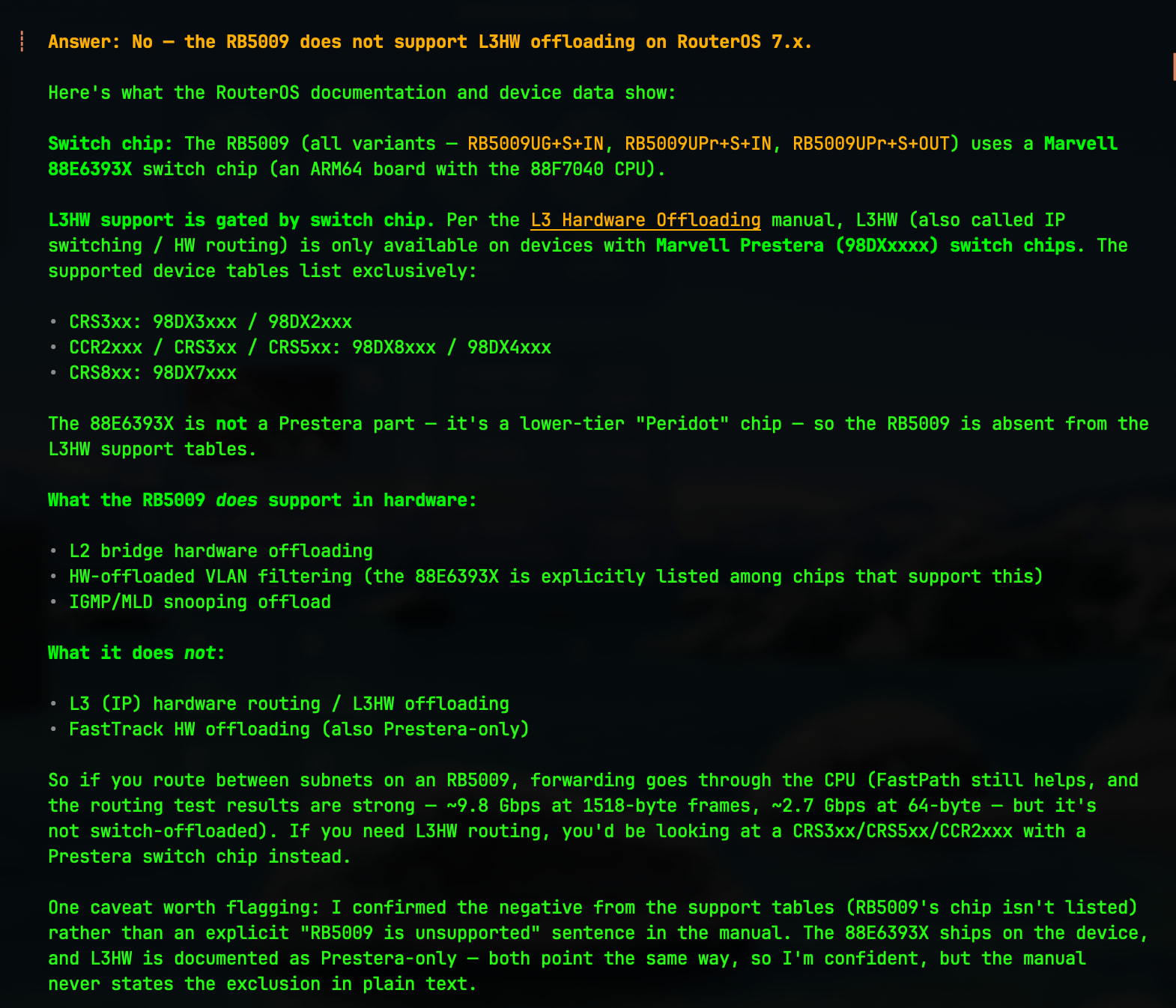

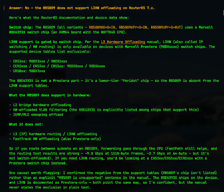

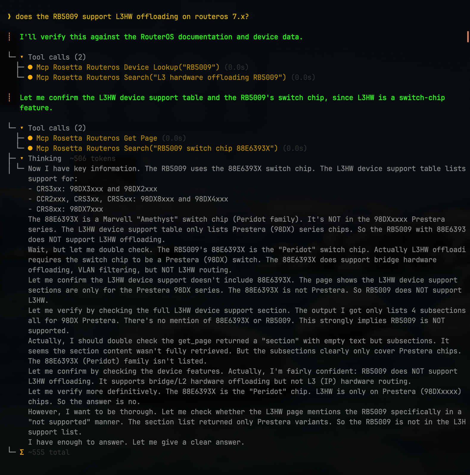

Rosetta can answer one of my go-to test question:
does the RB5009 support L3HW offloading on routeros 7.x
You'll see it reaching out toRosetta. And Hermes shows the "extending thinking" of the model (e.g. LLMs, essentially, writes notes to itself before answer):
And answer is basically right, "No":

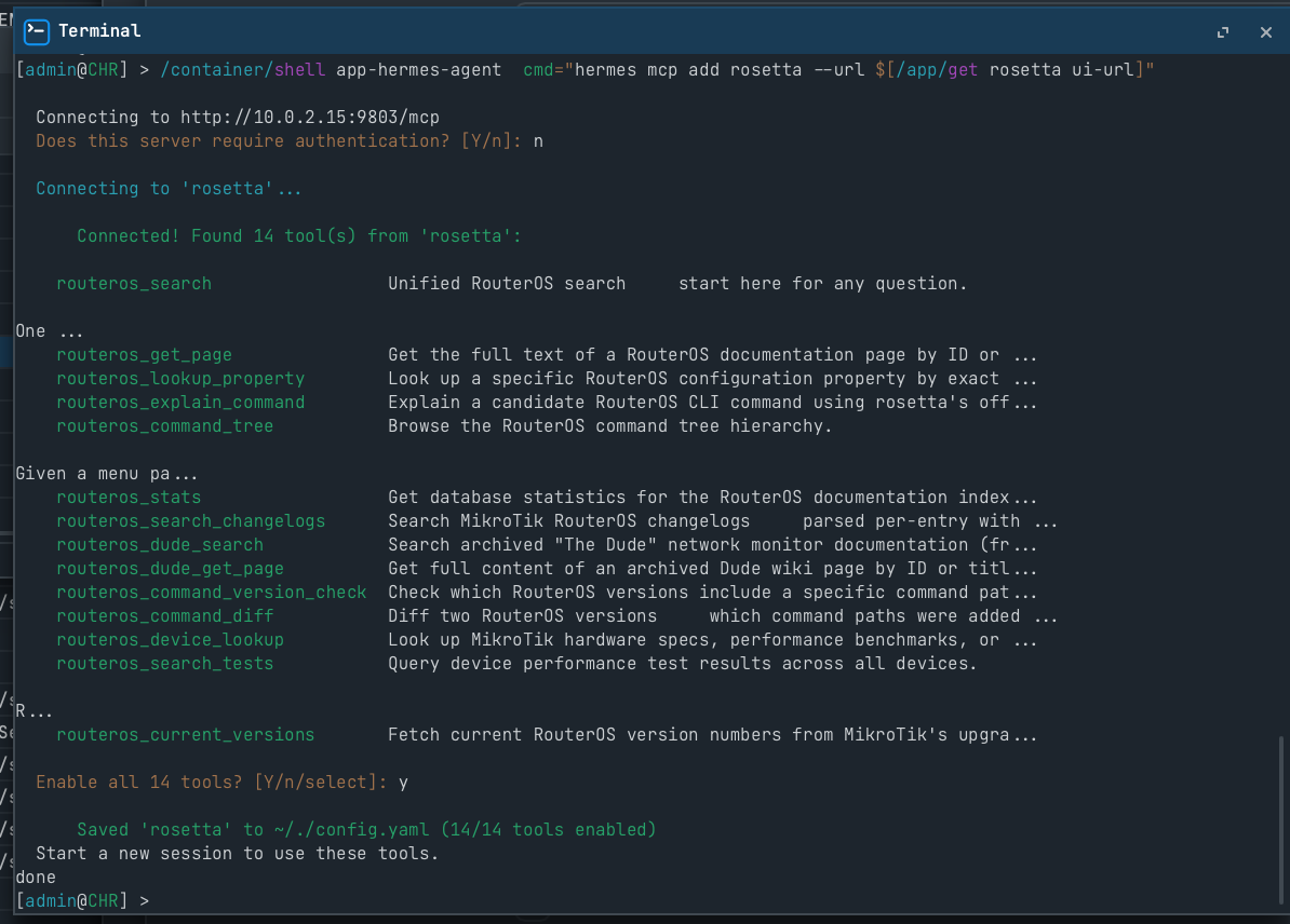

So if you do have Hermes working as /app, you then add Rosetta MCP as a "custom" /app using:
/app/add use-https=no disabled=no yaml="name: rosetta
descr: \"RouterOS Docs for AI assistants - use URL as MCP server\"
page: https://tikoci.github.io/p/rosetta
category: development
icon: https://tikoci.github.io/p/rosetta.svg
default-credentials: \"none - just use 'ui-url' as the MCP server in your AI assistant\"
url-path: /mcp
auto-update: true
services:
  rosetta:
    image: ghcr.io/tikoci/rosetta:next
    container_name: mcp-server
    ports:
      - 9803:8080/tcp:web
This is using ghcr.io/tikoci/rosetta:next which gets the newest Docusaurus version of Rosetta. Once 0.11.0 moves to "stable" (:latest), the :next part can be removed, which then use :latest by default. Also since I test with free/trial CHR... so there is no /ip/cloud so the use-https=no but in most cases it can be =yes
So with both rosetta and hermes-agent running, you can then add Rosetta to Hermes /app using:
/container/shell app-hermes-agent  cmd="hermes mcp add rosetta --url $[/app/get rosetta ui-url]"
Selecting "N" to authentications, and "Y" to install the Rosetta tools:

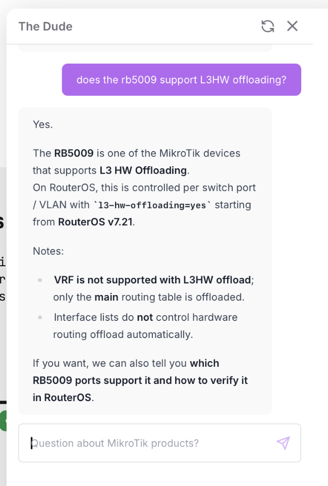

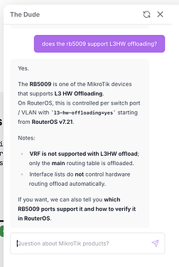

FWIW, the help.mikrotik.com "The Dude" chatbot did not provide a very good answer:

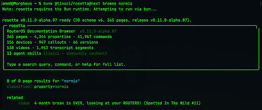

You can get you're own TSV export using bunx @tikoci/rosetta@next export /tmp/rosetta-export which will get you half-dozen TSV with a good bit of rosetta's DB data exposed. The TSV files should just open in something like Excel or Numbers/etc.
So while an AI agent can find similar data, you can use the TSV to see whatever view of various MikroTik things Rosetta stories. One is the list of YouTub videos (along with transcripts which are indexed by Rosetta), so if you were every curious on the "most popular" MikroTik video on YouTube with have Top ~20 (filtered in Numbers to year >20200101 and view_count > 100000).
