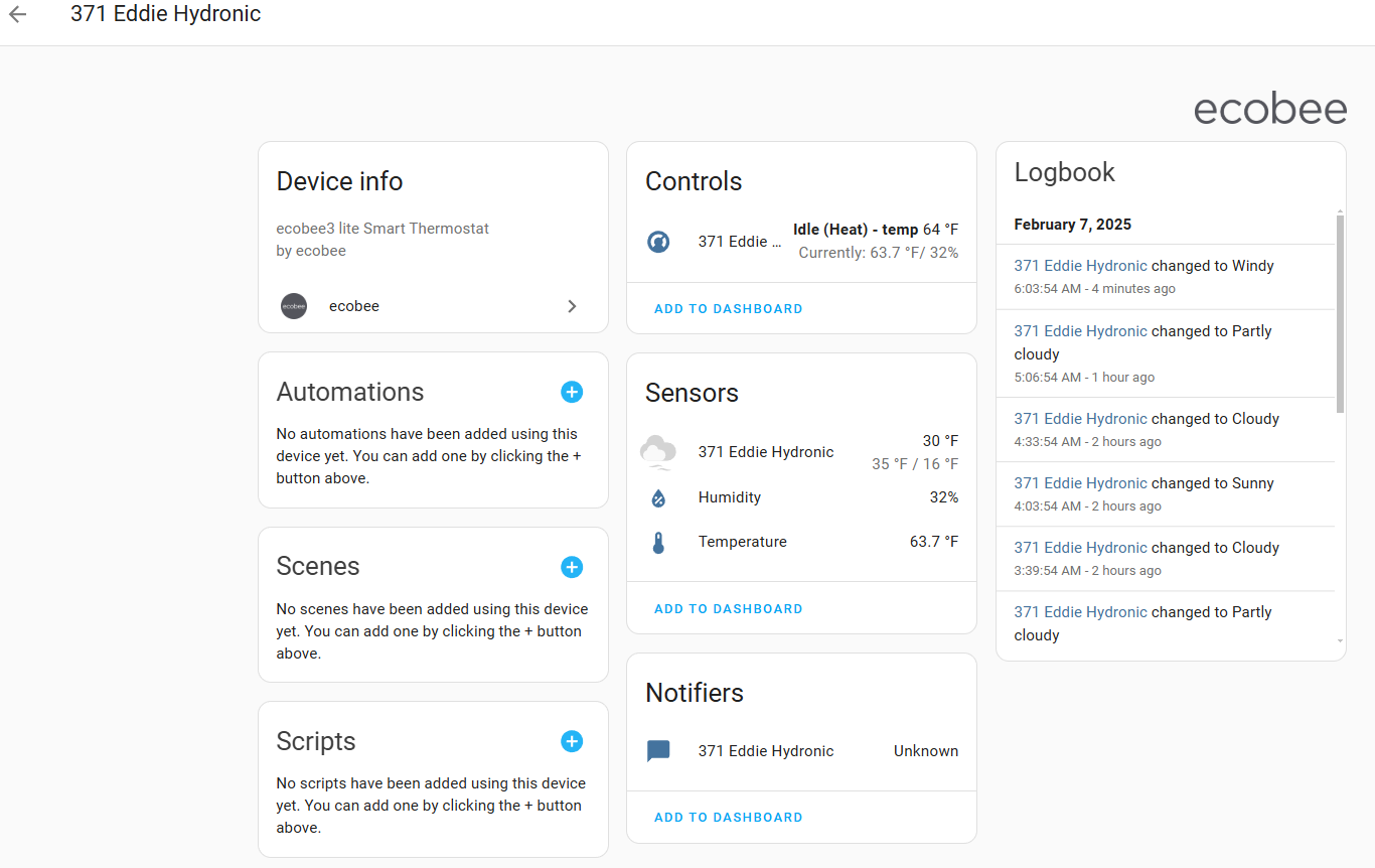

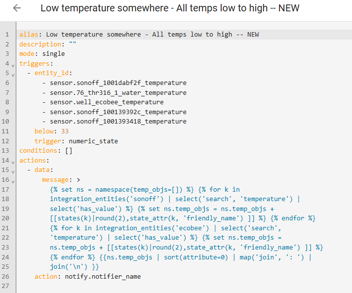

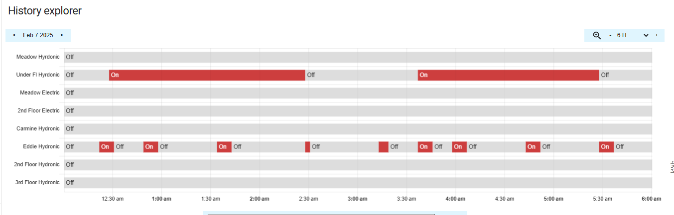

I’ve also been thinking about getting some Ecobees. Do you use them standalone, or together with something like Home Assistant or another system?
I use them with Home Assistant and have been (generally) happy with them. The combination of Ecobee and HA is extremely powerful.
But, like so many (all?) other technical devices, a little luck and a lot of patience is required.

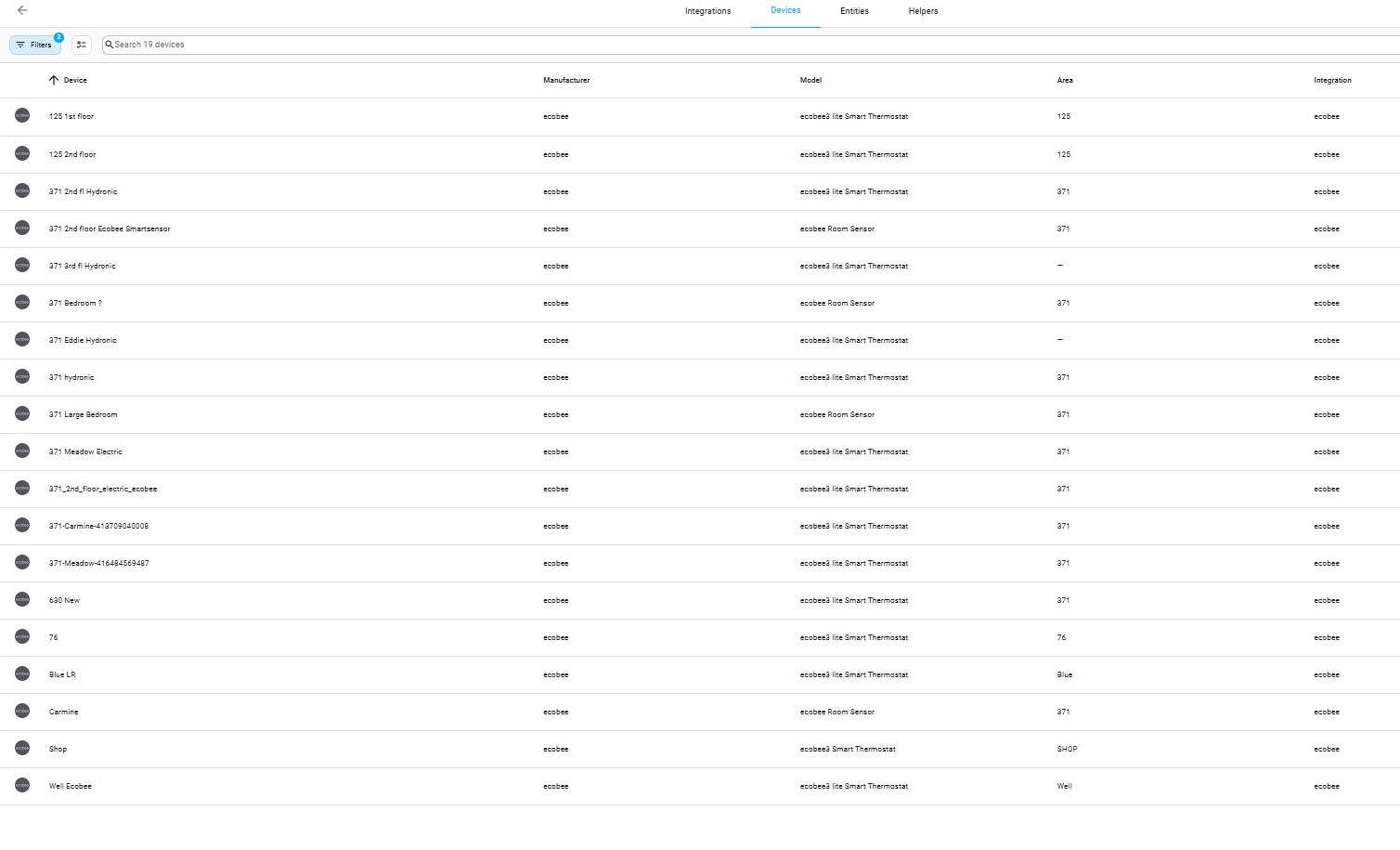

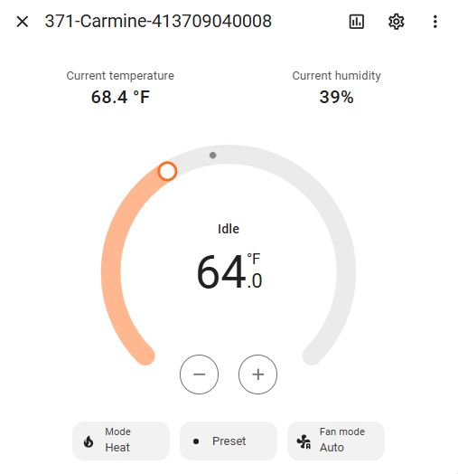

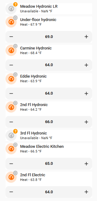

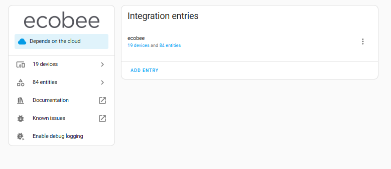

Here are some pics of how I use them (I’m sure there are other ways also).

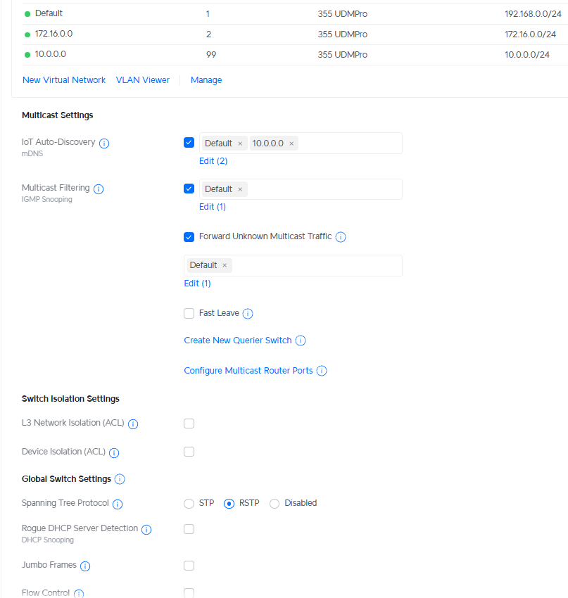

Is dhcp snooping enabled on any of the ubiquiti gear, it might cause this.
(Apparently it may be a default in some of their gear)
Good idea, but no, DHCP snooping is not enabled.

In a mixed environment (Unifi APs and MT router) the MT router might not be able to sniff Ethernet traffic because its hardware switch chip forwards frames in silicon, bypassing the CPU entirely.

Definitive per-ecobee status:
bash /root/ecobee_status.sh
This script checks each ecobee via the most reliable method available for its site: conntrack, ARP (fasttrack hides conntrack), pcap IP frame analysis.

  • bridge, not a router: For MT devices that are configured as bridges (and not routers) ecobee traffic to the is handled at the router/gateway. It does not route or NAT. Check cloud connectivity at gateway/router. The TZSP sniffer devices connected to a bridge-only will only sees mDNS, not cloud traffic.
  • Ecobee post-reboot mDNS-only state: After a power cycle, an ecobee may spend time in mDNS discovery mode (_ecobee._tcp.local queries) before establishing its cloud connection. This is normal boot behavior, not a failure. Do not confuse mDNS-only traffic with a wedged state -- wedged ecobees produce LLC/XID frames, not mDNS.
  • HA unavailable false alarms: The HA WebSocket listener fires on every "unavailable" transition, but the ecobee cloud API occasionally reports brief unavailable states for ecobees that are actually connected. These generate disconnect log entries and email alerts that are false positives. Always verify via conntrack/ARP before concluding an ecobee is actually down.
