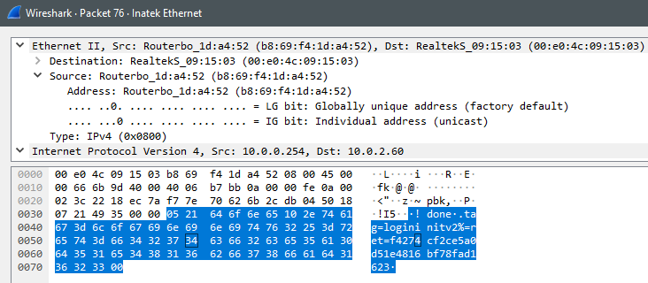

I don’t think that API is returning =ret, it looks more like a bug in that C code.
To verify what exactly RouterOS is sending back run a packet sniffer.
Ran Wireshark, and can see the =ret data…
Anyone else see this issue? I see many updated example API implementations support falling back to original login method when the =ret is found in the return data. For my case it would treat the login of my 6.45.1 ROS as legacy and then try to original login method which fails.
So why is legacy return data happening in ROS that deprecates that legacy login method?
OK I feel really dumb :blush: It was a typo on my part and is even evident in my output log posting. I had one too many ‘s’ in password
2019/07/18 12:55:32 WriteWord       Word to write is =passsword=8F0250DFD3A7FFEA2B3E2CD3D2E6F14865E973D3
2019/07/18 12:55:32 WriteLen        length of word is 51
But there is still the question why does a 6.45.1+ ROS still respond with the legacy login =ret when that has been deprecated?? I think it would alleviate future confusion to not give that response if not supported.
