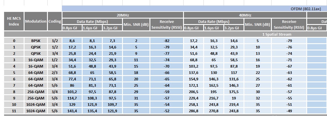

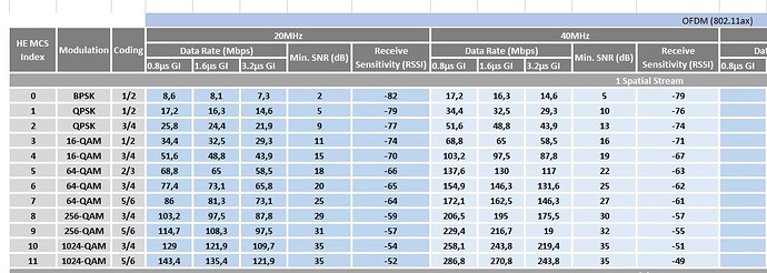

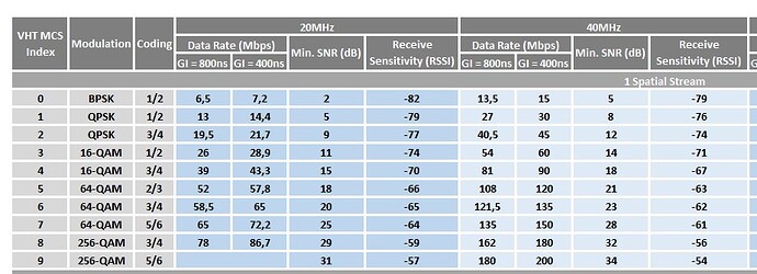

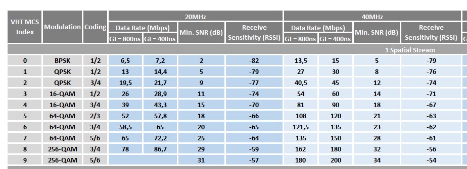

It seems you didn't understand what I was talking about.
To consistently transmit 400 Mbit (200x2) in the AC standard, you need to have a signal-to-noise ratio of 34 dB and a signal level of -54 dB in a 40 MHz band with two spectral streams. This would be MCS9 (GI400ns) modulation. To consistently transmit 573 Mbps (286.8x2) in the AX standard, you need a signal-to-noise ratio of 35 dB and a signal level of -49 dB at reception in a 40 MHz band with two spectral streams. This would be MCS11 (0.8µs GI) modulation.
