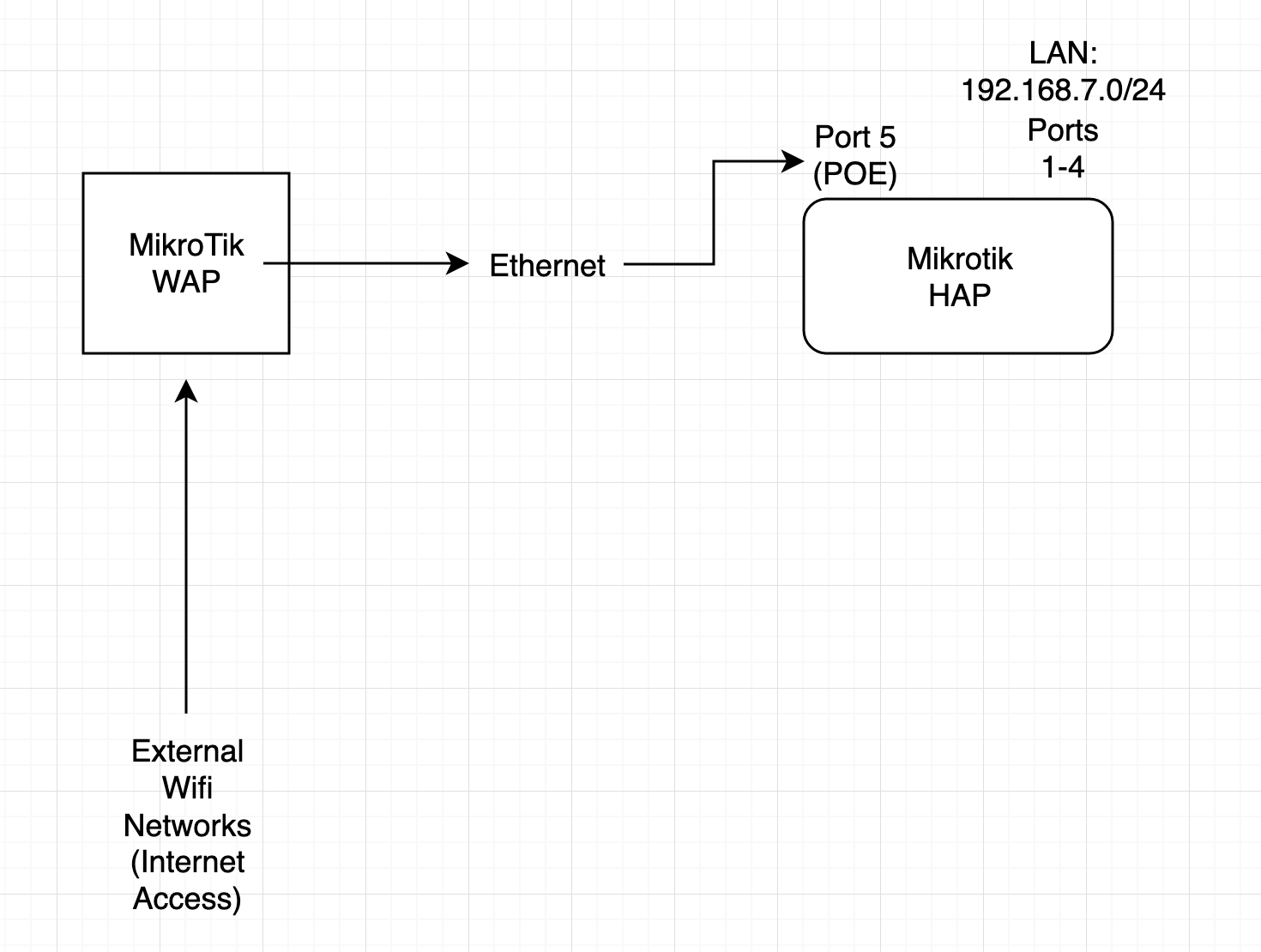

I have an RV, inside the RV is a HAP. This will provide wireless and Ethernet for the local devices in the RV. Simply DHCP private network, dhcp, ports 1-4 on a bridge. No issue with that.
A WAP is plugged into port 5. This wap is outside the RV and will get internet from my office (or public wifi wherever the RV happens to be) and bridge it to the HAP inside the RV. Simple right? I thought so too.
The issue is on the WAP. I can put it in station mode, it grabs an IP via DHCP from an external network no problem. I put it in pusedo bridge, turn off its DHCP client. Activate DHCP client on eth5 of the HAP. Now the HAP, since bridged to the WAP, should grab an ip. It doesnt. If i enter an IP manually it will work. But it cant get that DHCP request for some reason. Ports on the WAP bridge are set to trusted, and i tried RTSP and none for protocol. I connect an old UBNT picostation in place of the wap…put it in bridge mode, and boom…it works perfectly. So why not the WAP? (I would just use the old picostation, but it lacks a connect list kind of feature, so i have to manually go in and re-select the station every time i move the RV. I have several offices and places im at a lot, so i would like to have them in the connect list, hence the use for the WAP.
I tried connecting the WAP directly to a PC, pusedo bridge mode, same issue…PC cannot get an ip from DHCP server. Ive got to be missing something simple here.

As far as i remember 802.11 does not really work with multiple clients on one Connection.
Basically the WAP has to masquerade all MAC addresses which breaks DHCP.
Try pointing the DHCP-Relay on the WAP at the real DHCP-Server.
I would have moved routing/NAT to the WAP instead. That would solve your problem.
The preferred setup is indeed to have the NAT/Firewall/DHCP server in the wAP, not in the hAP. (http://forum.mikrotik.com/t/transparent-bridge/146361/1)
Then you just work with “station” to the ISP, not pseudo bridge. DHCP works in theory with pseudo bridge, but the Mikrotik bridges seem sometimes not to be able to handle this properly. (DHCP lease gets offered but not bound. see: http://forum.mikrotik.com/t/ros-6-38-serious-dhcp-server-problem/105259/1 , no real stable solution or root cause found yet. STP protocol and bridge port MAC learning are suspects.)
In all cases check where you define DHCP client and server. If interfaces are bound to the bridge, IP addresses, DHCP client and DHCP server should only be defined on the bridge, not on the interface.
In your pseudo bridge setup the wAP can also have an IP address. If the ISP does not allow 2 IP addresses, he might be caching the wAP MAC address for many hours. (while denying any other DHCP request from another MAC address. ISP trying to avoid double connections.)
If you have issues I would start on WAP as a fully bridged AP (double NAT will not cause an issue here).
On WAP use “QUICKSET” CPE mode, select router (not bridged) and bridge ports, enable DHCP server etc. (other Ip subnet than on the hap)
It should work this way. Once working improve further or keep it as this!
I really dont want the WAP to do the NAT, for the reason i want the HAp inside the coach to be the main routing device. It will have multiple ways to grab internet, the WAP is just one of them. The others are LTE, a plain ethernet to a port at my place, or via the USB port. If i do keep it as is but put the WAP on NAT, yes, it works…but tripple NAT.
I find it crazy the WAP cant do what a cheap $20 ethernet extender can do. The UBNT picostation does it fine, but lacks the connect list…but i guess will work if i setup some hacking way to do a connect list on it.
–John
You dont need to have Double / Tripple NAT, just configure routing properly between the wAP and hAP.
I sincerely doubt the $20 ethernet (WiFi) extender is going to provide you connectivity to other ISPs, etc as you travel
Treat the WAP as device on the LAN. and make the LAN vlan20
Create a bridge on the WAP for the vlans for the incoming signal and assign vlan10 to that traffic (access port).
On the HAP create the vlan structure for the lan vlan20
Associate vlan10 with the dhcp client and ethernet interface.
Seems like that would work.
OP did not explain the wAP config. If you want the wAP to be transparant between ISP and hAP, then “pseudo-bridge-clone” should be used.
