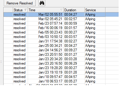

THis is dude output on static adresses how it looks like.. This is scenario with 12 subrouters with static adresses, under each router is next 20 custs. ANd those are suddenly disconnecting, then appearing after few minutes.. The statistic looks like this:
There were no power shortages etc..
