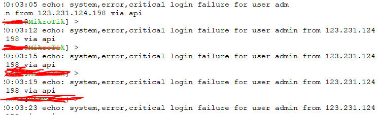

Hi all,
after i got all my network set up and running.
i found this alert
may i know how to stop this ? or this is a common occurrence ?
Please mark this as solved,
once I disabled the API services no more funny msgs.

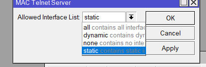

i’m following this instruction to securing the mac-server
https://help.mikrotik.com/docs/display/ROS/First+Time+Configuration
i can’t add the local interface
such as the example given in the link
/tool mac-server
disable 0;
add interface=local;
when I check in winbox GUI, there isn’t an option for add
only have the attached options
how should i add only for the 2nd port access ?

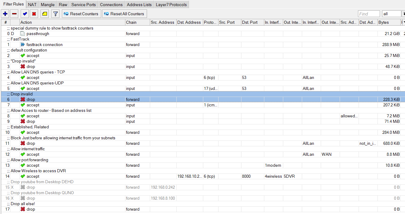

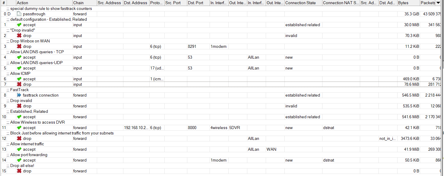

i’ve attached complete export as well
add action=fasttrack-connection chain=forward comment=FastTrack \
add action=accept chain=input comment="default configuration" \
add action=accept chain=input src-address-list=allowed_to_router
add action=drop chain=input comment="\"Drop invalid\"" connection-state=\
    invalid
    "block Just before allowing internet traffic from your subnets" \
    dst-address-list=not_in_internet in-interface-list=AllLan
add action=accept chain=forward comment="Allow internet traffic" \
    in-interface-list=AllLan out-interface-list=WAN
add action=accept chain=forward comment="Allow port forwarding" \
    connection-nat-state=dstnat connection-state=new in-interface=1modem log=\
    yes log-prefix=PortForwardedTraffic
add action=accept chain=input comment="Allow LAN DNS queries - TCP" \
    connection-state=new dst-port=53 in-interface-list=AllLan protocol=tcp
add action=accept chain=input comment="Allow LAN DNS queries-UDP" \
    connection-state=new dst-port=53 in-interface-list=AllLan protocol=udp
add action=accept chain=forward comment="Established, Related" \
add action=drop chain=forward comment="Drop invalid" connection-state=invalid \
    log=yes log-prefix=invalid
add action=drop chain=forward comment="Drop all else!"
add action=masquerade chain=srcnat out-interface=1modem
add action=dst-nat chain=dstnat comment="to see cctv from outside" dst-port=\
    8000 in-interface=1modem protocol=tcp to-addresses=192.168.10.254 \
    to-ports=8000
add action=dst-nat chain=dstnat comment="to see cctv from wireless network" \
    dst-port=8000 in-interface=4wireless protocol=tcp to-addresses=\
    192.168.10.254 to-ports=8000
noted on the bridge and thanks, apple fanboy LOL
fwreview2nd.rsc (10.2 KB)

argg…the order of your rules is now messed up.
For easy reading and less errors typically one has all the input rules grouped together and all the forward rules grouped together…
add action=accept chain=input comment=“default configuration”
add action=drop chain=input comment=“"Drop invalid"” connection-state=
invalid
“block Just before allowing internet traffic from your subnets”
add action=accept chain=forward comment=“Allow internet traffic”
add action=accept chain=forward comment=“Allow port forwarding”

add action=accept chain=forward comment=“Established, Related”
add action=drop chain=forward comment=“Drop invalid” connection-state=invalid
add action=drop chain=forward comment=“Drop all else!”
Also,
(1) You still have wide open address lists for subnets to the router vice an actual list of admin Devices IP addresses.
(2) The green block of rules in teh middle should all be moved down as a group just before the last DROP ALL RULE in green. AKA after the invalid rule.
(3) The input chain rule for allowed access to router should be moved down one to below the invalid rule (well see 4 first lol).
(4) The input chain rule for ICMP should be just after the invalid rule and before the allowed access rule.
Okay I missed this before…
add action=dst-nat chain=dstnat comment=“to see cctv from wireless network”
If you want the wifi network to be able to access the CCTV that is a forward firewall chain rule and stick this just before the drop all rule (assumes the CCTV is on 5DVR)
add chain=input action=accept in-interface=4wireless out-interface=5DVR dst-address= 192.168.10.254 dst-port=8000 protocol=tcp
The question I have is what protections do you have from accessing the DVR from the outside?
Is there a simple username login? Is it encrypted?
In other words, your CCTV may be open to the world???
they work, only on 1 pc, but doesn’t work on the the other, which is weird.
I’ve make a post of it here http://forum.mikrotik.com/t/youtube-block-works-for-1-pc-but-not-working-for-other-pc/150524/1

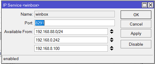

Ok, i’ve updated the address list to access winbox service as such
now only accessible from port 2 and 2 static IP.
ok, this should be how it looks.
Number 8 rule should already follow your sugestion “(1) You still have wide open address lists for subnets to the router vice an actual list of admin Devices IP addresses.”
number 3 and number 6 seems similar, only different in input & forward, should 3 move to 6 and delete 6 ?
please cmiiw, but rule number 2 & 10 is the same, so number 2 should be deleted ?
Number 9 is also i think not needed ? this drop everything that is input, similar to drop everything else in number 17.
exported firewall as below

ok, I’ve cleaned up the firewall list rule
the code export as below.
# jul/20/2021 23:33:31 by RouterOS 6.48.3
# software id = XF6Q-13TJ
# model = RB750Gr3
# serial number = CC220DD3DF58
/ip firewall address-list
add address=192.168.0.242 list=allowed_to_router
add address=192.168.88.2-192.168.88.254 comment="Service Port IP" list=allowed_to_router
add address=192.168.8.100 list=allowed_to_router
add address=0.0.0.0/8 comment=RFC6890 list=not_in_internet
add address=172.16.0.0/12 comment=RFC6890 list=not_in_internet
add address=192.168.0.0/16 comment=RFC6890 list=not_in_internet
add address=10.0.0.0/8 comment=RFC6890 list=not_in_internet
add address=169.254.0.0/16 comment=RFC6890 list=not_in_internet
add address=127.0.0.0/8 comment=RFC6890 list=not_in_internet
add address=224.0.0.0/4 comment=Multicast list=not_in_internet
add address=198.18.0.0/15 comment=RFC6890 list=not_in_internet
add address=192.0.0.0/24 comment=RFC6890 list=not_in_internet
add address=192.0.2.0/24 comment=RFC6890 list=not_in_internet
add address=198.51.100.0/24 comment=RFC6890 list=not_in_internet
add address=203.0.113.0/24 comment=RFC6890 list=not_in_internet
add address=100.64.0.0/10 comment=RFC6890 list=not_in_internet
add address=240.0.0.0/4 comment=RFC6890 list=not_in_internet
add address=192.88.99.0/24 comment="6to4 relay Anycast [RFC 3068]" list=not_in_internet
add action=accept chain=input comment="default configuration - Established, Related" connection-state=established,related
add action=drop chain=input comment="\"Drop invalid\"" connection-state=invalid
add action=drop chain=input comment="Drop Winbox on WAN" dst-port=8291 in-interface=1modem protocol=tcp
add action=accept chain=input comment="Allow LAN DNS queries - TCP" connection-state=new dst-port=53 in-interface-list=AllLan protocol=tcp
add action=accept chain=input comment="Allow LAN DNS queries-UDP" connection-state=new dst-port=53 in-interface-list=AllLan protocol=udp
add action=accept chain=input comment="Allow ICMP" protocol=icmp
add action=fasttrack-connection chain=forward comment=FastTrack connection-state=established,related
add action=drop chain=forward comment="Drop invalid" connection-state=invalid log=yes log-prefix=invalid
add action=accept chain=forward comment="Established, Related" connection-state=established,related
add action=accept chain=forward comment="Allow Wireless to access DVR" connection-nat-state=dstnat connection-state=new dst-address=192.168.10.254 dst-port=8000 \
    in-interface=4wireless log=yes log-prefix=WirelessToDVR out-interface=5DVR protocol=tcp
add action=drop chain=forward comment="Block Just before allowing internet traffic from your subnets" dst-address-list=not_in_internet in-interface-list=AllLan
add action=accept chain=forward comment="Allow internet traffic" in-interface-list=AllLan out-interface-list=WAN
add action=accept chain=forward comment="Allow port forwarding" connection-nat-state=dstnat connection-state=new in-interface=1modem log=yes log-prefix=PortForwardedTraffic
add action=dst-nat chain=dstnat comment="to see cctv from outside" dst-port=8000 in-interface=1modem protocol=tcp to-addresses=192.168.10.254 to-ports=8000
add action=dst-nat chain=dstnat comment="to see cctv from wireless network" dst-port=8000 in-interface=4wireless protocol=tcp to-addresses=192.168.10.254 to-ports=8000
/ip firewall service-port
set ftp disabled=yes
set tftp disabled=yes
set irc disabled=yes
set h323 disabled=yes
set sip disabled=yes
set udplite disabled=yes
set dccp disabled=yes
just curious, which one you haven’t seen ?
dermawas, one hint:
/interface detect-internet
set detect-interface-list=none
without checking if they are right or not, or something is missing, this is the correct order of the one already written:
add action=accept chain=input comment=“default configuration - Established, Related” connection-state=established,related disabled=yes
add action=drop chain=input comment=“"Drop invalid"” connection-state=invalid disabled=yes
add action=accept chain=input comment=“Allow LAN DNS queries-UDP” connection-state=new dst-port=53 in-interface-list=AllLan protocol=udp
add action=accept chain=input comment=“Allow LAN DNS queries - TCP” connection-state=new dst-port=53 in-interface-list=AllLan protocol=tcp
add action=accept chain=input comment=“Allow to router” disabled=yes log=yes log-prefix=AdminAccess src-address-list=allowed_to_router
duplicated —> add action=accept chain=input comment=“Allow ADMIN to Router” disabled=yes log=yes log-prefix=AdminAccess src-address-list=allowed_to_router
add action=drop chain=input disabled=yes
add action=drop chain=forward comment=“Drop youtube from Desktop DEHD” disabled=yes layer7-protocol=youtube src-address=192.168.0.242
add action=drop chain=forward comment=“Drop youtube from Desktop QUNO” disabled=yes layer7-protocol=youtube src-address=192.168.8.100
add action=accept chain=forward comment=“Established, Related” connection-state=established,related
add action=drop chain=forward comment=“Drop invalid” connection-state=invalid log=yes log-prefix=invalid
add action=accept chain=forward comment=“Allow port forwarding” connection-nat-state=dstnat connection-state=new in-interface=1modem log=yes log-prefix=PortForwardedTraffic
add action=accept chain=forward comment=“Allow Wireless to access DVR” connection-nat-state=dstnat connection-state=new dst-address=192.168.10.254 dst-port=8000 in-interface=4wireless log=yes log-prefix=WirelessToDVR out-interface=5DVR protocol=tcp
add action=drop chain=forward comment=“Block Just before allowing internet traffic from your subnets” dst-address-list=not_in_internet in-interface-list=AllLan
add action=accept chain=forward comment=“Allow internet traffic” in-interface-list=AllLan out-interface-list=WAN
