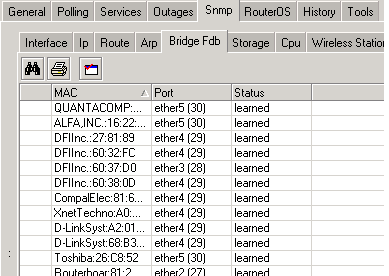

Actually it is possible to view Bridge FDB information from SNMP, that is what I have in Dude,
