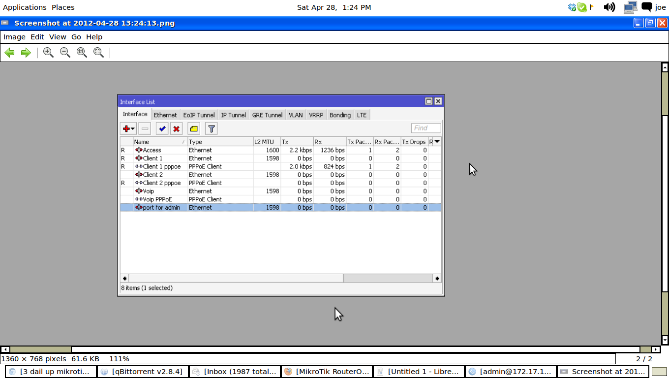

OK here it goes, i have a house with 2 clients on the premises the one client wants 1meg PPPoE the other wants a 4 Meg PPPoE and they want to use VOIP also PPPoE..
On the 750 I have..
1: Ethernet 1 links up to a Air Grid M5 in Bridge mode
2: Ethernet 2 setup for client 1 ( DHCP)
3: Ethernet 3 setup for client 2 ( DHCP )
4: Ethernet 4 setup for Voip ( DHCP )
I have setup PPPoE Dial-up
1: PPPoE Dial-up for client 1
2: PPPoE Dial-up for client 2
3: PPPoE Dial-up for Voip
For some reason I can get the Nat and the routing to work, each client must go out on his own PPPoE Dial-up .
we have also set up on Radius Manager 4 that..
client 1 gets a ip address 10.1.0.198
client 2 gets a ip address 10.3.0.188
Voip gets a ip address 10.5.0.120
