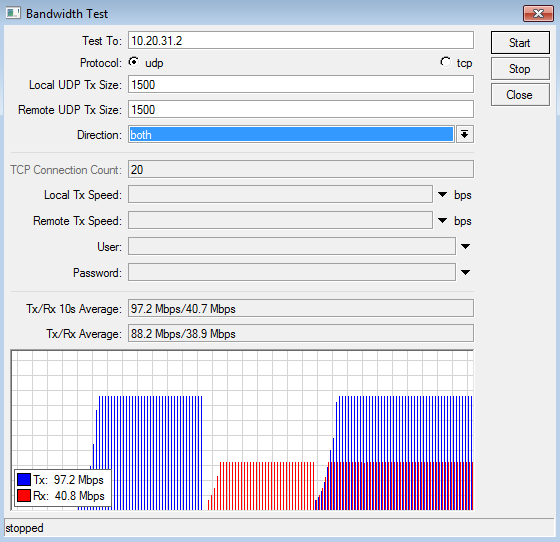

Strange bandwidth asymmetry (see below).

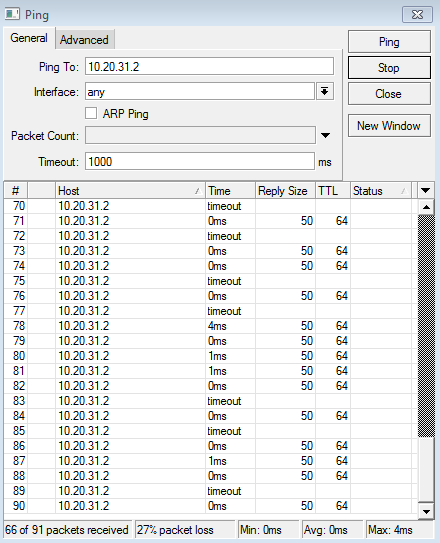

No ping lost when Tx is at it’s max. (about 97 Mbps), but many drops when Rx is
at it’s max (about 40 Mbps).

When bonding ether2 and ether3 on both 433s (balance rr),
bandwidth of the bond is the same 97/40 Mbps :frowning:
I would like to have 200/200 or something like that.
