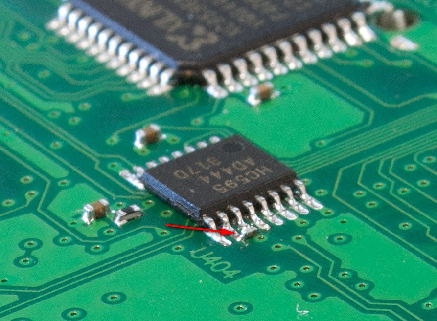

Can you check if the following part exists on the legs of the HC595 chip?
Yes smd capacitor is present
Tell it is possible to solve most?
Skills of the soldering smd and even tsop it is enough microcircuits
To know as where to correct
To send back on a guarantee in other country fussy enough
Please use a magnifying glass to check if the capacitor is securely placed. If not, you could try to fix it. But anyway, you should contact the seller for warranty repair/
The soldering ideal
What face value at capacitor?
It would be desirable to learn in what particularly problem?
In original photos this part is absent…
It not software a problem?
Simply I doubt that there not regularly that that from the point of view of chips or the soldering
Most likely it is an error to you it is known also its decision it is any updating of the scheme
If the nobility what…
My RB493G came with this capacitor but there is strange behavior when SD card is inserted… When SD card is inserted quantity of bad blocks progressively increases. But even if I remove SD card and make NAND formatting quantity of BAD blocks stays as before.

Hi Normis, what can be the issues caused when that part is missing?
I currently have rolled out a bunch of 493G’s which - after 6 weeks of operation - start to crash and reboot periodically.
I have no idea as to why they are doing this. There was no change in configuration.
What’s significant is that bad-blocks are detected after that short period of time. 0,1% up to 0,3% and more - where then board won’t boot to operational state anymore.
Power supply shouldn’t be the causing one, because there are different PSU used in field. And other boards connected to that same PSU are not affected.
