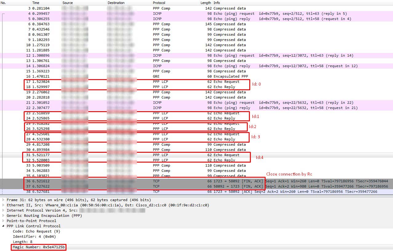

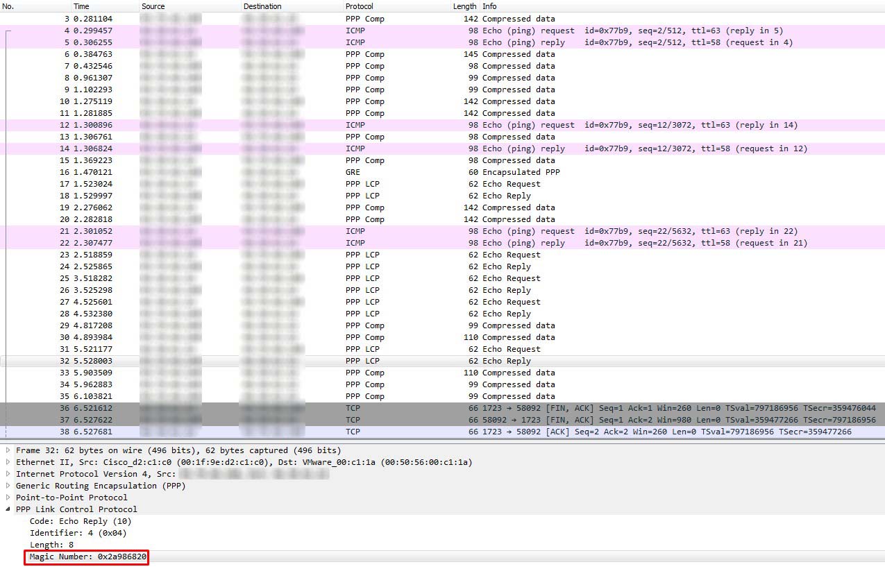

3) However, this is not the case if you look at a dump of external traffic on a central Rc
The dump is taken from Rc itself using the “Packet Sniffer”, i.e. this traffic definitely got to the router.
We see that traffic is exchanged, we see all five LCR request and LCP Reply to them, magics are match (only for some reason inverted), the answers came in less than 10 ms, but for some reason the PPP/PPTP Service on the Rc router didn’t see this traffic, it thought that the remote Rr1 didn’t answer him and broke the VPN connection, although, in fact, the traffic to the router came.
Reconnection occurs immediately and then the VPN works fine until the next similar problem.
Other VPNs, at the time of the fall of one, work fine.
It looks like at some point, for some reason, the PPP/PPTP service on the Rc router stops receiving traffic and disconnects, although the traffic was definitely coming to it, including and all five LCR responses.
P.S. Tried with L2TP, such problems are not observed.
