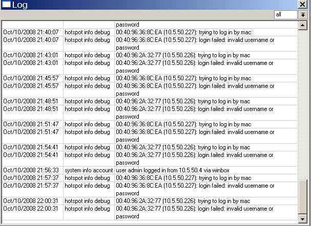

  2. I notice that in the hotspot LOG, that two of my “Cisco AP343 Bridges” are being logged as “trying to log in to the hotsopt”. IP=10.5.50.226 and 227 are two of my bridges.) I never saw any indication of that before. See attached LOG (second) image. What can be causing this?

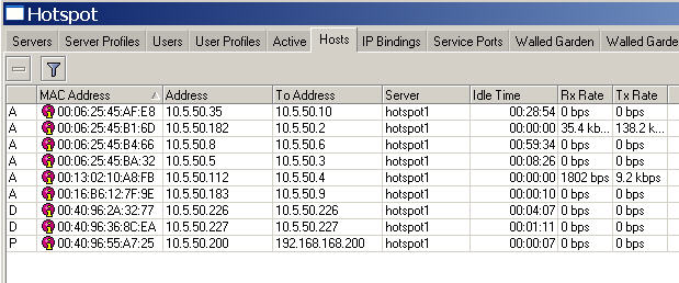

  3. I Notice also that IP=10.5.50.226 and 227 are shown in the HOSTS list (below) but my other two bridges are NOT shown there. Why are the bridges shown in the hosts list?
  4. I notice in the first image below of the Hotspot HOST page, that the IP addresses in the first column are shown to be transferred to an address in the second column: IE, 10.5.50.3 to 10.5.50.5.
    What does this mean?

  1. The hotspot hosts list shows that the IPs in the left column are being masqueraded as the IPs in the right column. This is normally because they are not getting the IP assignment from your hotspot, or the IP asignment expired. Not a problem.
  2. The access points in question probably have some setup that requires a connection to the internet (NTP,DNS,etc). If the other AP stations don’t request anything for the idle-timeout period (5min default), they will drop from the host list. Still not a problem.
When the APs try to access the internet, they are stopped by the hotspot. To allow access for your APs,
/ip hotspot ip-binding add address=10.5.50.226 type=bypassed
/ip hotspot ip-binding add address=10.5.50.227 type=bypassed
