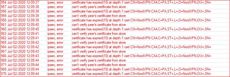

Strange Cert. error with some NordVPN connections
I have a multiple connections with NordVPN and just saw that I had errors in the log about the certificate.
The certificate is running till 1 January 2036 so that could not be the problem.
Other connections to NordVPN are working fine and reconnect.
The only thing I can think of is that the server is having a different certificate than the local certificate store provides.
Any ideas how to test that?
