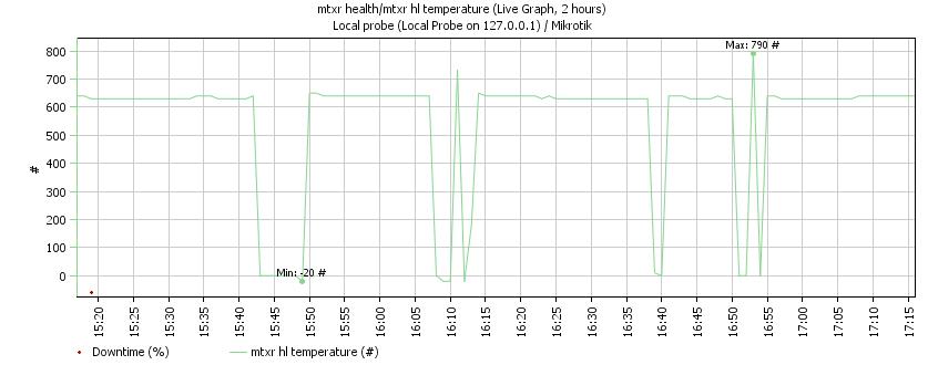

I have noticed strange behaviour of System health - temperature and voltage suddenly change very strong - to -2 C (see files)
What does it mean? Motherboard problems?

These are reports from PRTG Network monitor (see below). Voltage sensor I turned on 1 hour before.
And I notice - then voltage/temperature go down, packets stop to go via the router.
