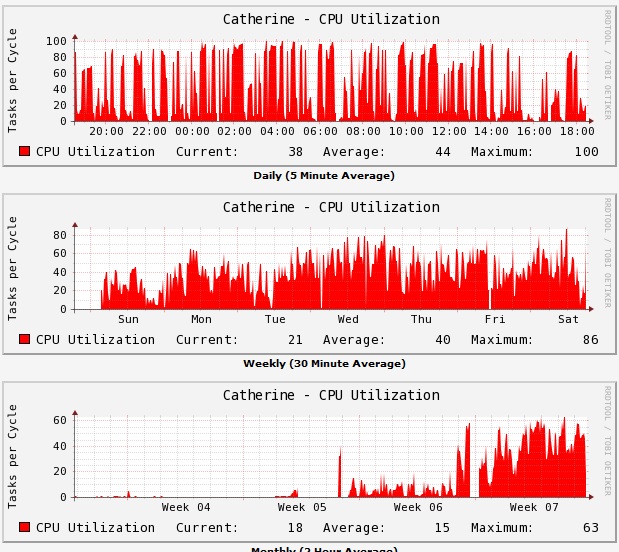

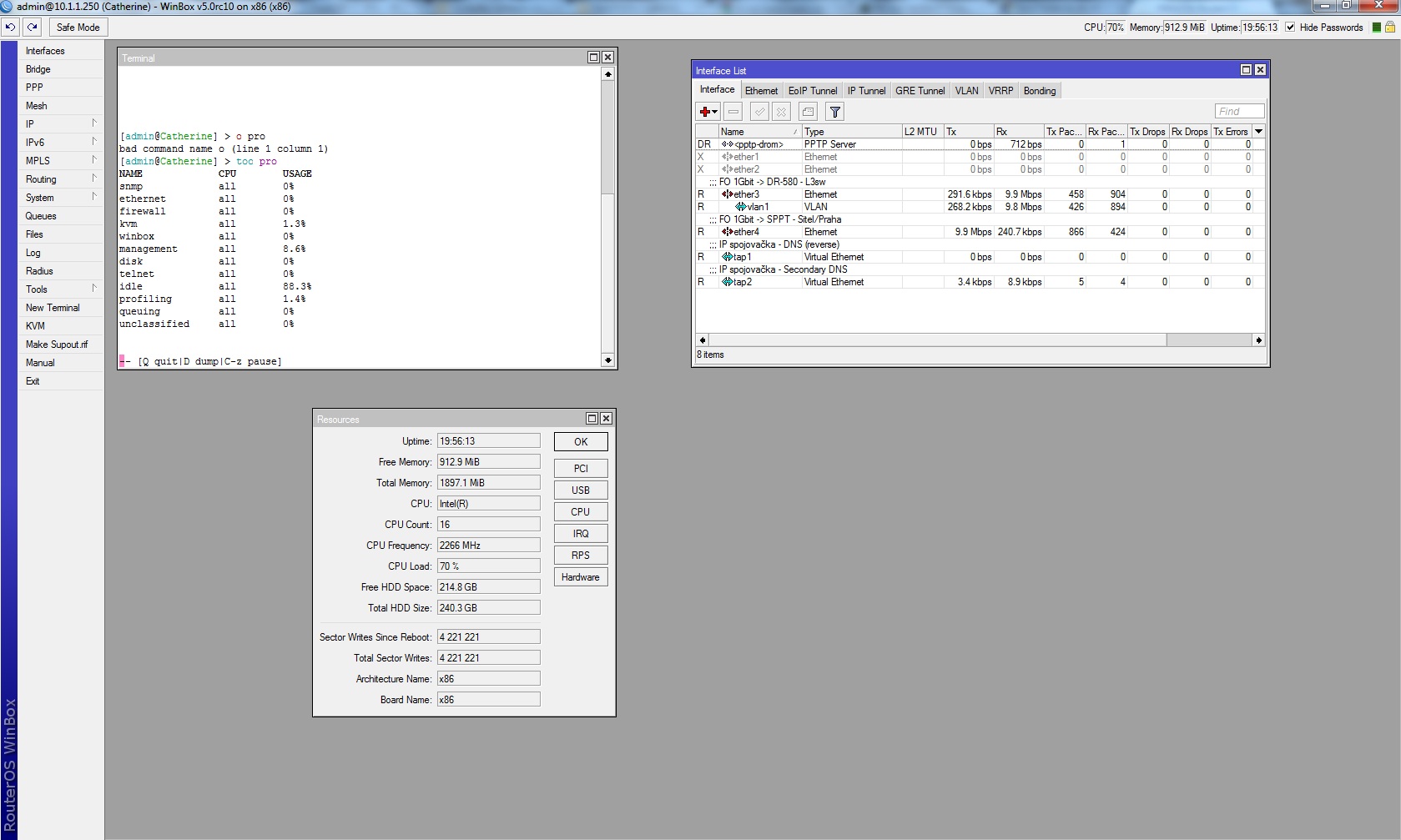

But there is some strange problem with CPU load. With no traffic, no QoS, only 2 virtual machines running (also idle) there is about 70-90% CPU load. On tools->profile is no high load process. System reboots sometimes on high load.
I attached screenshot from winbox and graph of CPU load. Can anyone help me with this problem?

I think you should disable HT on those CPU’s.

ok, one step at a time, it is tested that with HT off, RouterOS works faster that with it turned ON, at least for routing related tasks.
