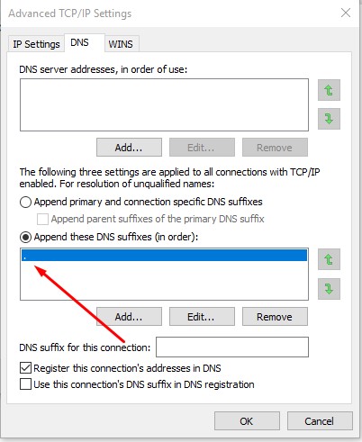

Omg Exiver, you are such a savior i spend the whole day yesterday troubleshooting this culprit. I used the solution that you posted and worked !
A simple dot → . in the dns suffixes did the trick. I don’t really understand the mechanics behind this, if anyone knows please put some light.
When you use hostname without any dot, Windows will always try to append domain suffix. If there’s some, your “server” becomes e.g. “server.mynet.local” and you don’t have such record. I’m not sure what it does when there’s none, if there’s some default suffix or if it fails. If you add “.” as suffix, your “server” becomes “server.” and it’s FQDN which is sent to resolver as is.
You don’t normally see ending dots in hostnames, but you can have https://forum.mikrotik.com./ and it’s correct too.
