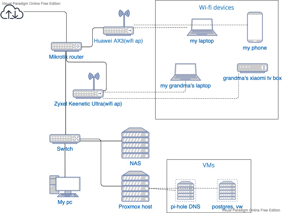

Ok thanks for info abt the forum. Devices are connected as i show it on the attachment
On all of these devices DNS is 192.168.2.228 (pi-hole server)

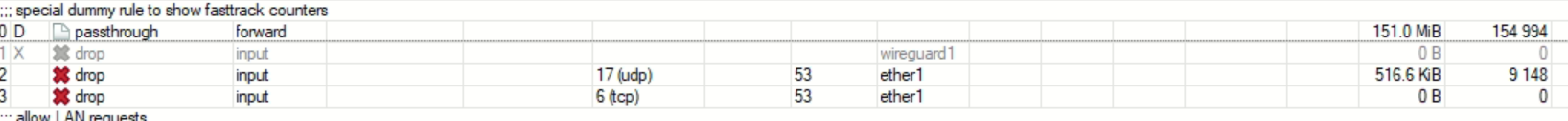

THX you helped me so much. added drop filter for dns queries and now it stopped.

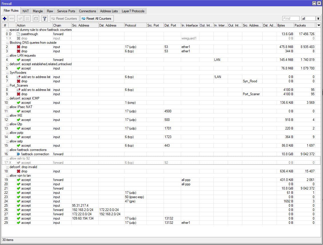

My firewall filter settings. What should i add to this to secure myself better?

Let me try to spare you a lashing…
Please order your firewall rules with input ones at the top and forward ones at the bottom. You would have been better served to keep the default rules as I can confidently say you set these up from scratch without understanding 100% what you’re doing…thus the DNS hijacking.
Your input chain should have an accept established, related rule at the top and a drop invalid rule next. Then put your input rules and at the end put a drop all rule.
Your forward chain should look the same way: accept established, related. Followed by a drop invalid. Put your forward rules and at the end you have a drop all rule.
Get that mess you currently have in order and resend your screenshot please.
