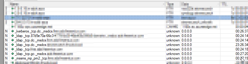

But when i try to do a gpupdate on my computer, i think that part of dns requests gets to the domain server and part gets to internal ros dns:

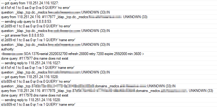

It looks like first request is correct, but next one ended with error:
And i see these requests on cache too:

  1. How can these requests get to ros internal dns resolver, when all other xxxx.mydomain.com request are correctly forwarded to outside domain dns server
  2. Why are these requests logged with some strange IPs (it’s changing time to time, now its 119.156.152.116) - i’ve try to turn on logging on all /input,fw,out,mangle/ rules and never catch any of these IPs to really comunicate with router and i have fw rule blocking outside dns requests.

Looking at the article you’ve posted, it only deals with redirection of DNS requests coming to Mikrotik’s private LAN IP, so presumably from the LAN.
But your log shows that the requests which don’t get redirected come from 118.251.24.116, which is a public IP address assigned to China Telecom. So unless you are really an expat, I guess these requests arrive to the WAN interface, which Johann’s setup ignores. This suggests that your firewall isn’t very tight and accepts at least DNS queries, if not something more, from outside.
So depending on what you actually want, you have to either tighten your firewall or modify the dst-nat rule so that it would handle also requests coming in via WAN.

OK, now I got it, there are actually two issues - why your PC on LAN sends DNS queries from a Chinese IP address, and why some queries to the same domain are redirected and some are not.
Regarding the first part I have no answer - if you tested the logging firewall rule for this address also on the LAN interface and it hasn’t logged anything when you’ve sent the gpupdate command, it must be a bug inside RouterOS because src-nat rules are not used in the input chain so no rule there can change the source address of the request.
Regarding the second part, the regular expressions are normally case-sensitive, I don’t remember whether it is the case with Mikrotik as well. So if domain names in some of the queries are in uppercase and in some in lowercase, this could be an explanation. I can also see that all of them are queries to SRV records, so I thought that the domain name may be encoded in some unusual format in the query packet so the regexp would not match on it, but RFC 2782 doesn’t indicate any special encoding format for the query fqdn. So check the upper/lower case theory.
