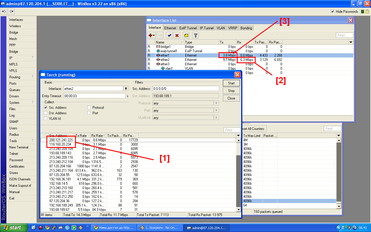

Let us consider a router with LAN interface ether2 and WAN - ether1. No additional interfaces that functioning at all. / tool torch shows that ip-addresses 200.121.241.221 and 118.160.20.234 make some (big) upload (for customer) traffic on my LAN interface. See [1] on attached picture. But I haven’t such addresses. They are somewhere behind our WAN interface.
Traffic can be reached only on our LAN interface as upload [2] and such traffic doesn’t exist on the WAN one [3].
This “alien behavior” makes conclusions on the network and worst QoS.

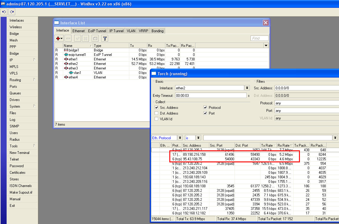

check ‘Protocol’ and ‘Port’ ticks to see what exxactly traffic it is
Hi there!
Thanks Chupaka for interest. And an answer.
Here are two screenshots with Port/Protocol marked. Nothing interesting can be observed on shots unfortunately.

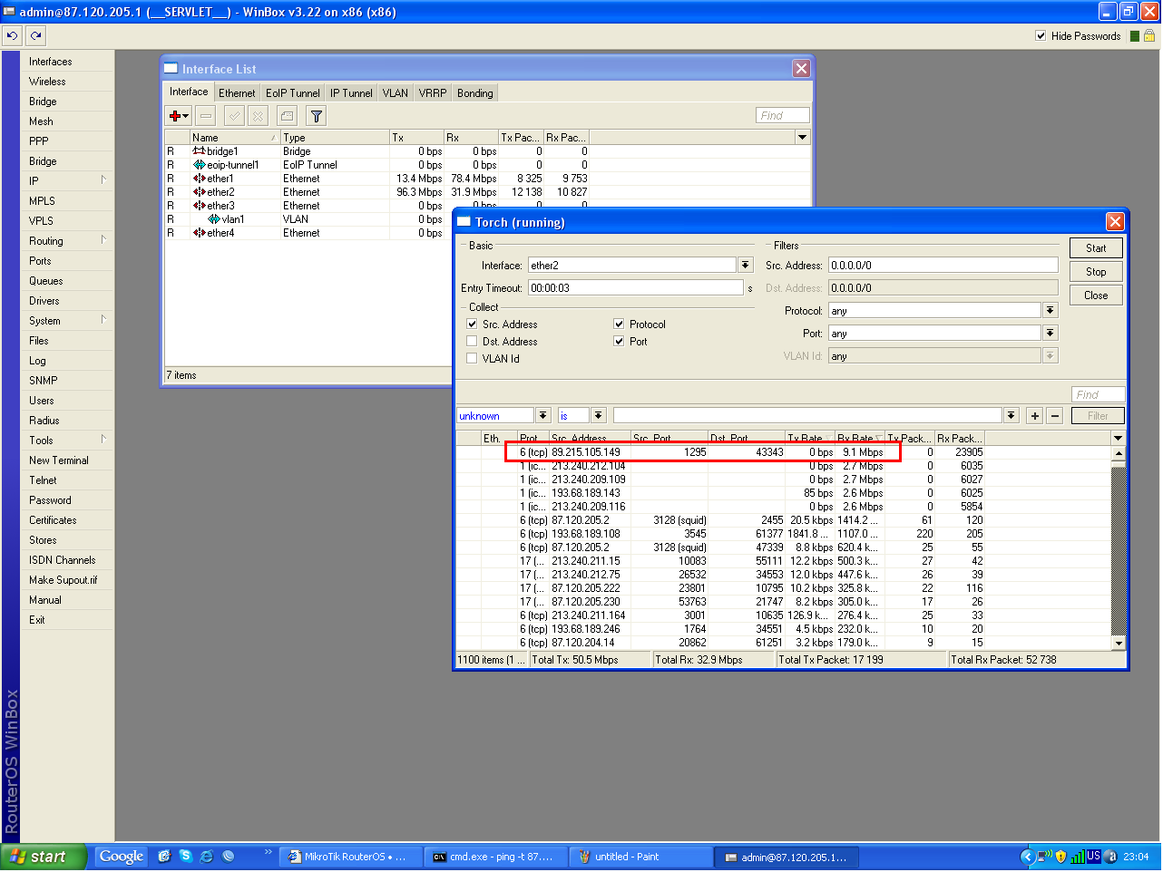

Look that “aliens” (ip-addresses not ours) do big amount of traffic BUT ONLY UPLOAD. With zero download:
They can make more than 100% of all routers traffic:
Both pics shows zero packets download and big amount of traffic uploaded.
And at last, this traffic stops if disable of WAN iface is made!

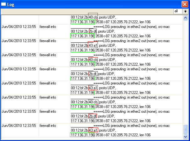

At last I captured successfully what actually goes on. I catch the villain…
See the picture attached to this post.
Notes:
[1]. ether2 is our LAN interface. There is only one more active interface - ether1, that is WAN interface.
[2]. “evil-doer” (green colored) acts from our LAN interface - just like he is our customer. But this is not our ip-address.
[2]. every attacker’s packet comes from different MAC-address (red colored) - maybe it’s an algorithm that changes last two parts of the addresses (see red frames on the picture).
Please, HELP!
This attack decreases router’s performance dynamically and stops some services at all.
Maybe I need new concept for routers firewall, but I do not understand what actually goes on.
