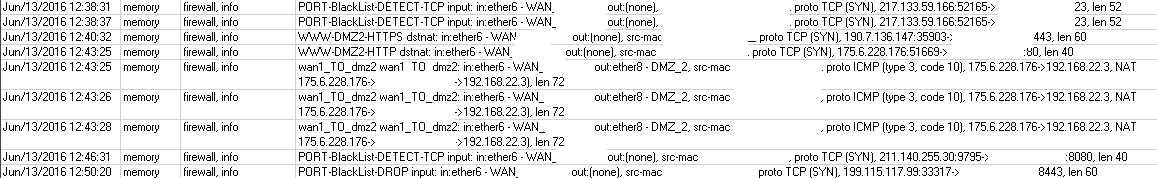

There comes a port 80 request from WAN and it will be routed via the NAT-rule to the DMZ server.
But the webserver logfile has no entry that any request on port 80 came in (this sometime happens).
And then there came three ICMP requests from the same IP to the WAN port. Why the ICMP packets were tried to forward to the DMZ server?
I block several ICMP packet requests on WAN port.
But why did the RB try to forward these ICMP packets (maybe because there was an active NAT-rule before)?
Is this a kind of attack?
How can a NAT-rule/request trigger such a ICMP packet although the port 80 request does not reach the webserver (webserver-logfile)?
Type 3 Destination Unreachable [RFC792]
Code 10 Communication with Destination Host is Administratively Prohibited

The traffic logged to ports 80 and 443 are going through the input chain, not the forward chain or your custom chain that is logging the three ICMP messages.
I could be reading this wrong, but it appears that the internal server has attempted to connect to the remote host, and the remote host isn’t recognizing the connections, and you’re seeing the ICMP replies from the remote host. Since the TCP handshake is never completing, this is why you wouldn’t see anything in the web server’s logs.

I believe that the port 80 request from the screenshot were manipulated packets, so they were not be forwarded to the webserver.
UPDATE: No, the ICMP packets will be blocked by the wan1_TO_dmz2 ruleset because no rule can be used.
Maybe this behaviour of sending an ICMP in TCP/IP protocol in this situation is normal?
It seems that your dstnat pinhole rules might be wrongly configured - because if these packets reached the INPUT chain, then this means that no dstnat rule matched them to map them towards the server’s internal IP. This has nothing to do with how “clean” the connectivity is - the rules should be simple - if tcp dst-port=80, and received on the wan interface, then modify the destination IP to be the internal IP of the server.
So your clue is to find out why these packets went into the Input chain - meaning that the Mikrotik considers these packets to be directed at itself, not any pinholes or LAN-side hosts.
As for the failed ICMP, these should work as “related” connections based on the http requests that caused them to be generated… but if the Mikrotik didn’t see any outgoing packets (output or forwarded) which might have generated these ICMP replies, then the replies won’t qualify as “related” connection state, thus they get scrutinized as “new” connections would.

And one more thing falls on - I also log my nat rules and you can see on the first screenshot that the nat rule matched (log entry: WWW-DMZ2-HTTP dstnat…). So the dst-nat rule for port 80 matched and should be forwarded to the webserver, shouldn’t?
