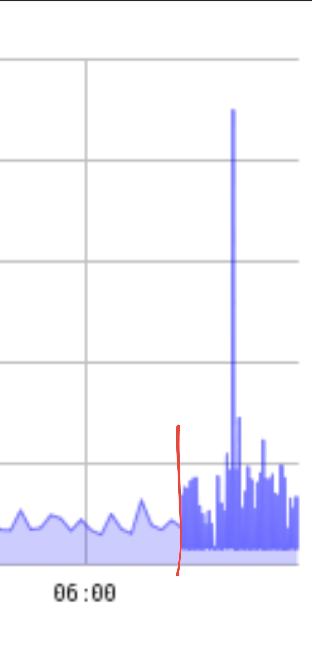

Since yesterday my graphs (all of them) have changed their plotting type.
They was so linear, now they are so confused.
I don’t remember having changed any setting about.
Might you suggest what’s happening and how to switch back?
Thank you
Gian

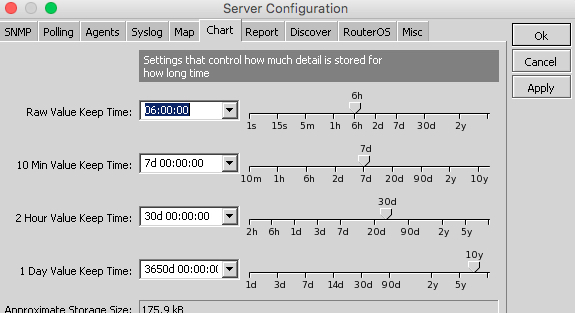

That is the expected behaviour - latest period of time is stored in max resolution, the next one - in lower (10 min), and so on (2 hours, 1 day).
You can change the exact time for each period in settings:
