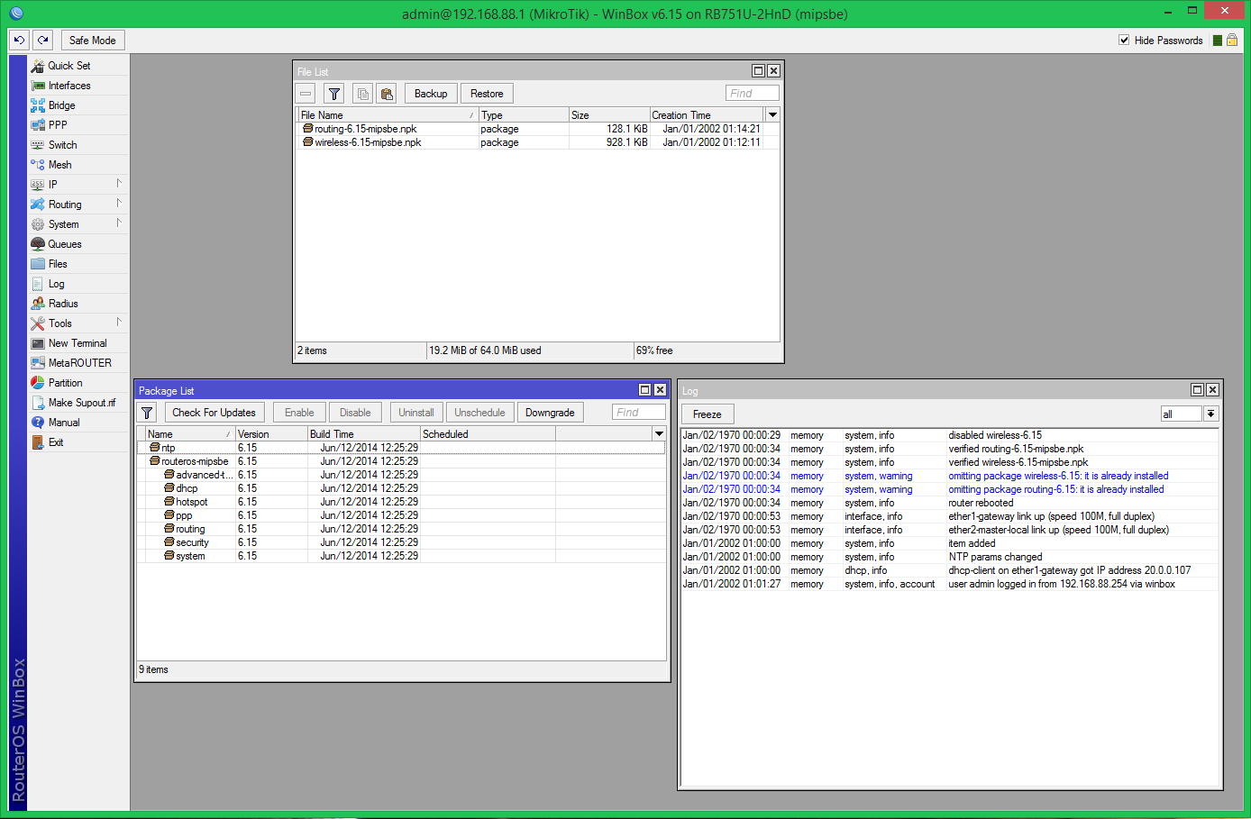

I have the same issue on 2 same hardware routers after upgraded to 6.15. I see this strange behaviour on one of them as you can see on the attached image.
Seems that the router has the wifi package installed but it wont appear on package list and when you try to install it and reboot… then you see this log message: “omitting package wireless-6.15: it is already installed”
I tried to explain that this happens after upgrading to 6.15, and uninstalling wireless-fp… maybe there is a problem and as Rextended suggest “packages that I wont used should be disabled instead of uninstalled” but if there is a problem when uninstalling them, it would be good to know!

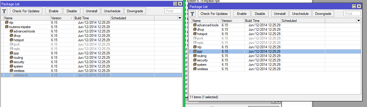

Now it works but I have one different thing (the package list structure tree) in the package structure inside the routerboard that I attache here (I think its because the way I installed on other routers, that I add ntp package after…)
