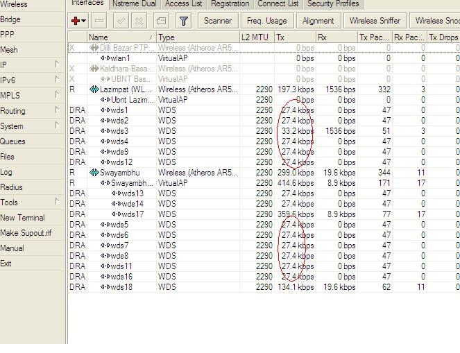

I got 4 Main AP with 4 sector on each with RB600, 800 & 433AH etc on different location with same vlan via fiber and ptp wireless. I’ve used AP with WDS mode on all and i saw strange issue with all of them. All connected clients/station wds can view on wireless table and all got same tx rate runnig. ( i have attached the picture of it.) Is it some kinda a flooding or what ? please any suggestion and help regarding this. I got high latency while pinging client bridge.
regards,
Srijan

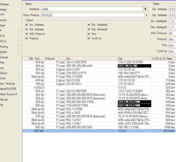

Have you tried torching the interface to see what the traffic is?
You can try to use a firewall.
Heres the my torch results for specific wds..
what might be cause…any sugestion

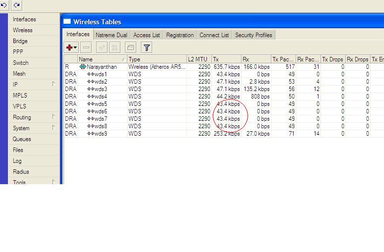

this is normal with wds (bridged network)
noting to worry about.
