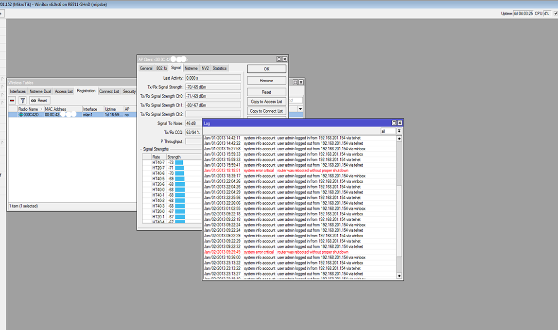

I upgrade two RB711-5hnD with last v6.0rc6, firmware 3.02.
It is PtP link.
On one side (client) router reboots every day or two and that is only problem..
On the other side (bridge) log says that router reboots but uptime period is still progressing like nothing happens, and there is no disconnect log on client side.

It is most likely general problem because same things happen on RB433GL.
