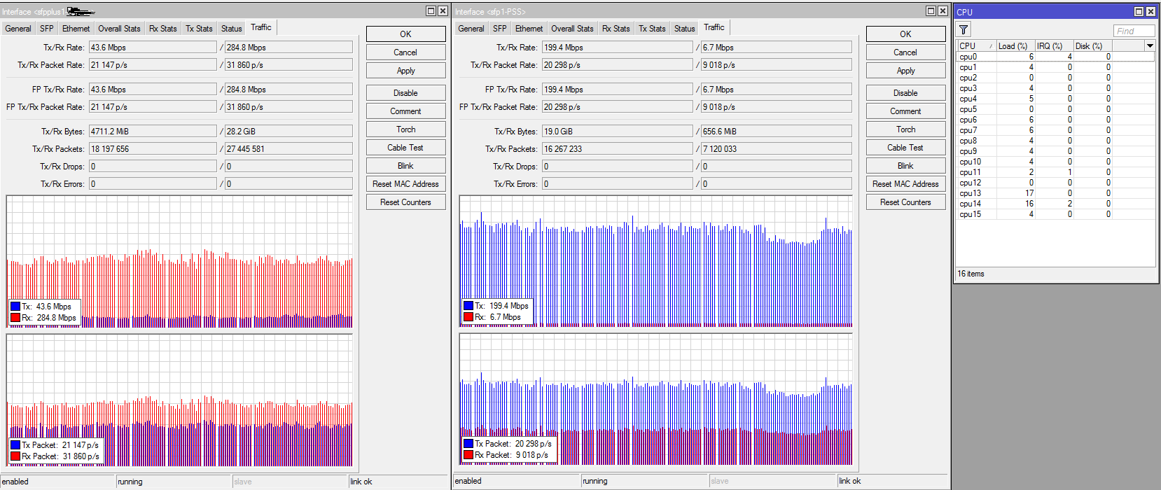

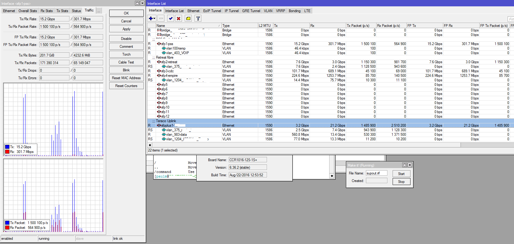

We have a 10Gbps link running between a RB1016+ and a HP switch. There is random spikes in traffic every minute or so too both the SFP+ and to a 1036 on a normal SFP port. i.e these spikes are not limited to just the SFP+ port. It actually seems to be across the entire Mikrotik switch. The packets per second increase from around 20000 to over 1 million. The traffic also goes over the limit of the interface e.g 20Gbps on a SFP+ port and over 15Gbps on a normal SFP port. Even some other SFP ports - the traffic would usually be around 20-30mbs increases for a few seconds to 200 or 300mbps.
These spikes last a few seconds, increases CPU etc, and then normal traffic continues.
Please see the picture.
However if I torch the traffic, it does not pick up these random traffic spikes? I have upgraded ROS to the latest stable and the latest firmware - this has not helped. This is causing some strange issues for us, e.g camera quality of streams etc. Any suggestions?

Not seen at all which is strange. I run a torch with an entry timeout of 5min, nothing untoward in the torch - nothing to explain the > 1000% increase in traffic and packets. I am running a torch on the interface and looking at the interface traffic graph, the spikes do no show up in the torch. The CPU usage does spike as well when there are these spikes.
It is almost like a flood of dummy traffic across the connected interfaces. I am also not seeing the traffic on the other side, e.g on the other Mikrotik or switch - i.e does not originate from them.
I am thinking this must be hardware related. CPU usage also spikes for no reason. There is no major config on this router. No PPPoE or firewall rules. Just a couple OSPF interfaces, few vlans etc.
