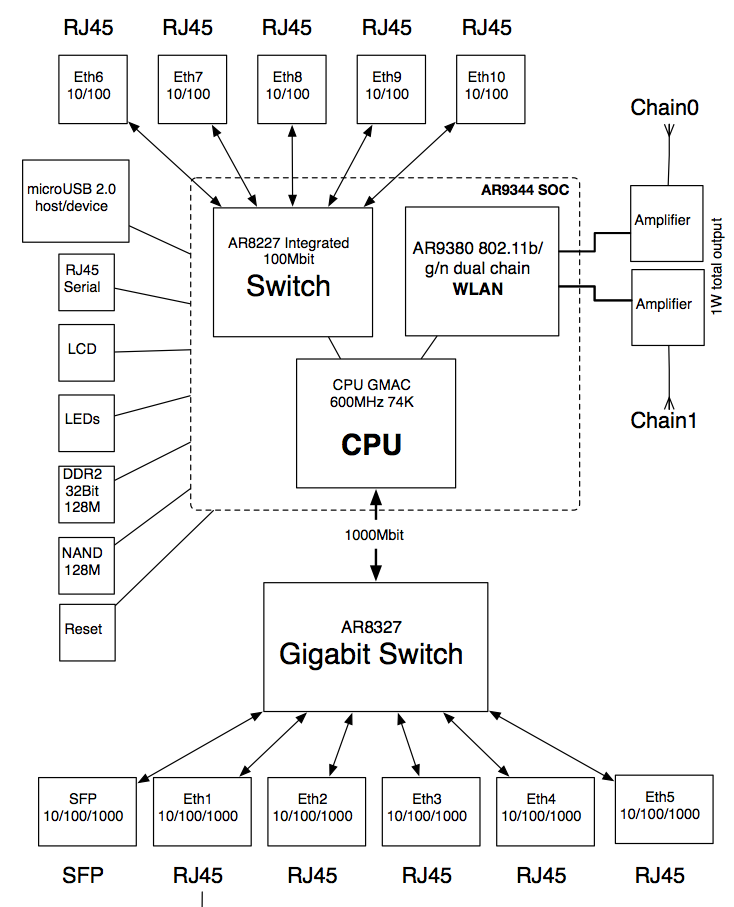

Post a config export… could be related to the fact both SFP and gigabit ports share the same switch lane towards the CPU. How do you auth towards your ISP, pppoe?

Does ether1 have a special status? The block diagram does not seem to indicate that.
I don’t really see why I should make ether1 the master of ether2-5.
Could I not keep ether2 as master of ether3-5 and make the bridge ether2-master plus ether6-master and activate fastforward on that?
