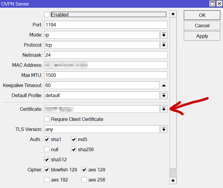

But first I tried to reset ovpn-server settings through WinBox it forced me to choose Cerfiticate field. How to unset “certificate” in ovpn-server settings?

The only question is how to remove the certificate selected for openvpn from the configuration.

As far as I understand, Certificate field cannot be left blank. If I did through the console, then the problem would not appear. But I already did it through winbox and now the certificate is selected.
So my question is how to reset a field that cannot be blank?

The value is “string” (id as string, for be precise) and can not be “nil”/“nothing”,empty, but at least one id.
No matter if exist or not one certificate with that id.
Using winbox you configure all the parameters at same time, and certificate is needed by ospf for work.
Is why winbox do not accept unexistant certificate and you must specify one.
Is not the reply to the queston, and at the same time netisntalling do not set any cert on "certificate", but still id as string "*0"

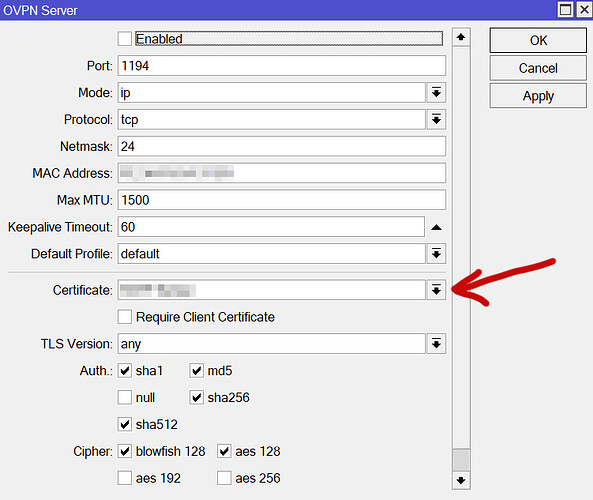

Actually, mine is “set” to unknown (where Certificate is presented in red).
"unknown" because winbox do not find the cert with id "*0"
If you add any cert to the device, if never set differently, here appear the first cert you add to the device.
If you "print" on terminal, you can see the cert id *0 (that probably on your device not exist)
