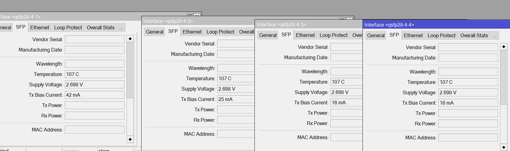

I have a crs504 and wish to run a 2.5g uplink on it.
I thought I could use a melanox qsfp to sfp adapter, and throw a s+rj10 into that, however I get incorrect temperature readings of 107c the second I plug in the module.
This causes the fans on the 504 to max out rather quickly.
An hp 1g sfp ethernet module without temperature monitoring works fine, and my s+rj10’s are r2 models
