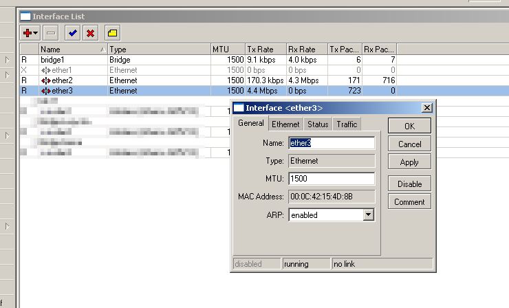

Attached you find a screenshot of some of our Routers when the error occurs (note – ether interfaces are NOT attached to any device at this moment).
At this moment there is a bandwith test to WDS-Slave (first interface)
The traffic shouldn’t go to ether1/2 and the other WDS-Slave - but it passes these interfaces!
