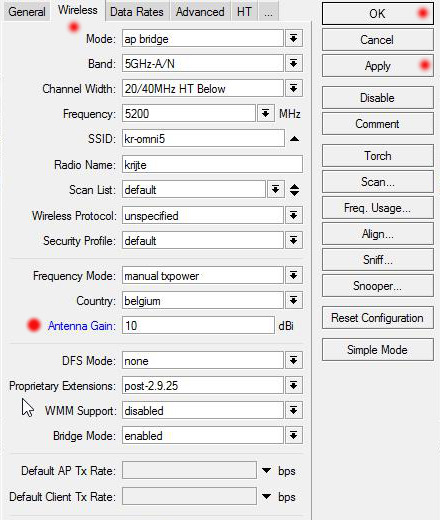

for reduce the power go to “wireless” wireless interface klik on advanced right below
Set antenna gain example on 10 dB on both sites
-29 dB is to match signal
for good must the around -60 dB
Reduced Antenna gain to 10 dBi
Reduced Tx power to 7 dBm

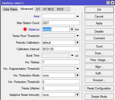

Still important select “indoors” by “advanced settings”

Distance = indoors
(but actually its not true, router is located outdoor, my laptop is facing window and I can see router, which is outdoors under roof)

Hey Dandaka, you can try with change the setting indoors to 1
Just as test en see what happend.
Think that the signal must go to the roof that affected also ping time
I don’t have “indoors” setting
I have setting “distance”, which I set to “indoors”
http://take.ms/rLHeG
No not indoors but 1
distance = 1 made it worse ![]()
Ok thats was a test, set it in like before.
