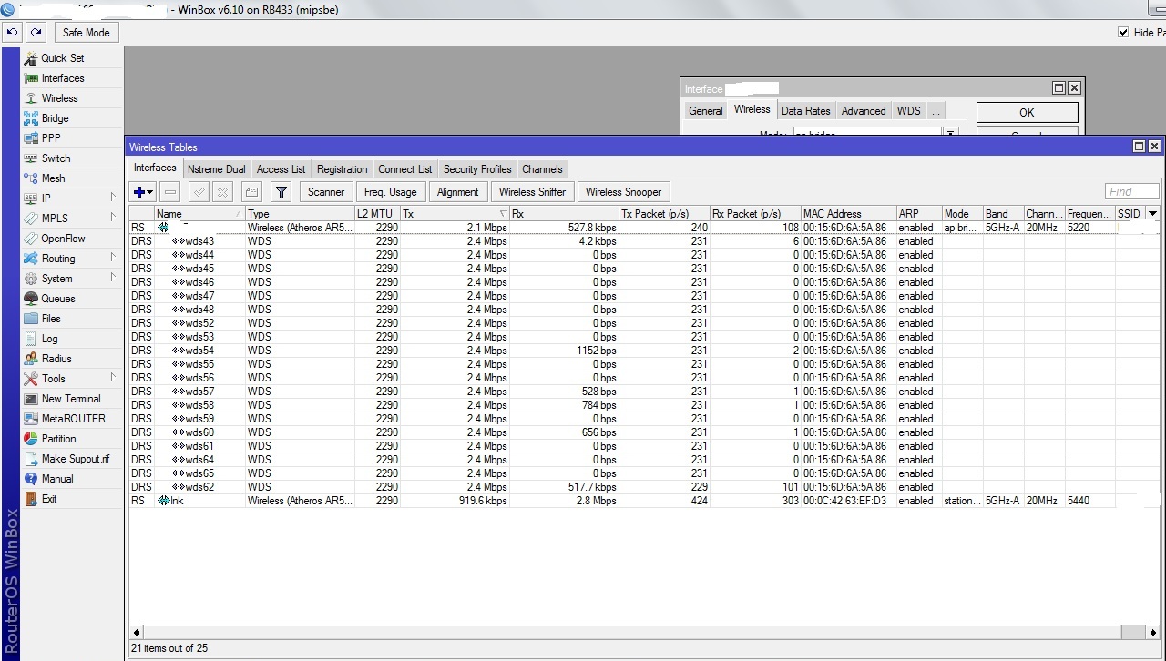

im facing a problem on one of my sectors, it gives random high traffic for all WDS devices connected to it without even any real traffic from customers; i tried updating my routerboard, changing frequencies, but still the same behavior.
i attached a pic that explains exactly what i have

This is not a wireless problem. I think you have too many mac addresses in your network and some switch is leaking traffic. And it will go to wds interfaces because they are bridged.
so how to solve such a problem on AP that connect clients, and prevent such issues?
