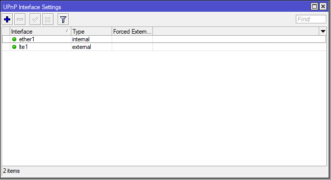

Enable UPnP on the Tik.
I have enabled NAT and UPnP on Tik and still Strict NAT. I though that in Passthrough mode it does 1:1 NAT and UPnP is not doing anything ? On ASUS i have as well enabled UPnP and NAT

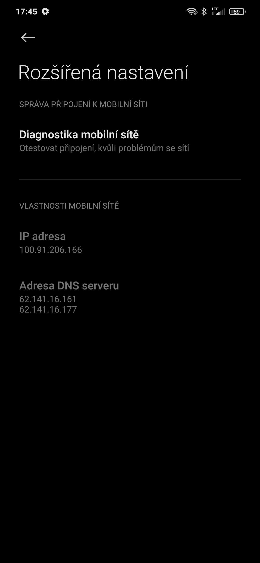

No I think this is purely problem of Mikrotik. I had same APN on TPLink and when I create hotspot from my phone(CGNAT see picture) I have moderate NAT. Tomorrow I will climb on roof and take SIM card back to TPLink and see if I get moderate APN
Sorry to everyone I have figured out that it is problem of ISP. I climbed on roof, took sim(O2 CZ} out of Mikrotik and put it in TP link and got same strict NAT. Then I put in Tik another T-Mobile SIM card, obtained CGNAT IP and got moderate NAT even without IP Passthrough. So I will try to ask about that my ISP and change to another if it is not gonna work.
