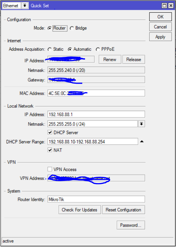

you should have a bridge interface which connect to all your LAN interfaces.
then you should create a dhcp pool and dhcp server which its interface need to be this bridge interface.
or you can use the quick setup method by press on the quick set button,

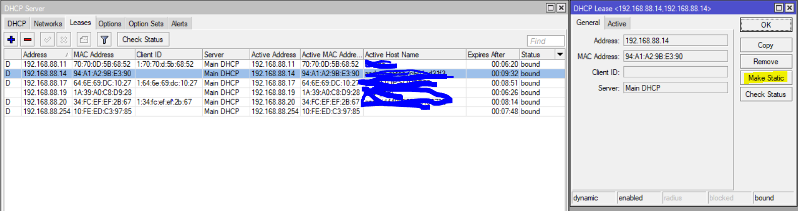

I had the dynamic portion of the DHCP server working correctly, It was in trying to set static IP leases via MAC where I ran into trouble there. They would just recycle busy status and never actually bind/lock into an IP. On occasion they would end up with a dynamic pool IP instead of their set IP.
I set this up 2 different ways in trying to make it work, first was manual input. The second was let it acquire a dynamic IP, then set it to static and change the IP. Neither seemed to work correctly for me.

As far as accessing the internet I can’t remember what all I tried, but I’ll be looking closer into the NAT/Firewall settings. To my understanding though, the default configuration that happens should allow internet access from the LAN, but I may be misunderstanding that.

Upon a clean slate I have managed to get static IP leases setup with only 1 IP that was switching between busy/bound/waiting constantly. I changed IP again and disabled>enabled it and it managed to fix it.

So let me get that straight you just want to make a static ip on your lan in order to make firewall rules better.
if so let your device lease an ip address from your dhcp server, then enter to the leased ip list and press on the ip you want to make static then press on make static (winbox)
or you can set the ip address on the devices themselfs and then remove those ips from the pool list.
