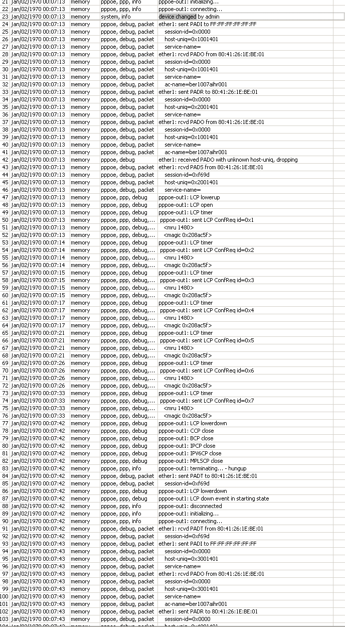

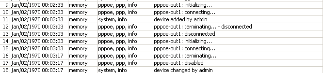

I moved my WAN2 (dual stack dsl, modem draytec vigor 130 doing the vlan tagging) from the usg to ether1 on the rb5009. Connected my computer on ether2, nothing else. I cannot for the life of me get the rb5009 to connect as pppoe-client, always ending up with the same symptoms. Connecting, terminating, disconnected loop. Sometimes terminating… -disconnected, sometimes terminating… hungup.
First I followed the MT help > getting started to the word. Upgraded to ROS 7.1rc4. Tried the default settings. Various other stabs in the dark. Tried a lot of different settings in the pppoe-out interface.

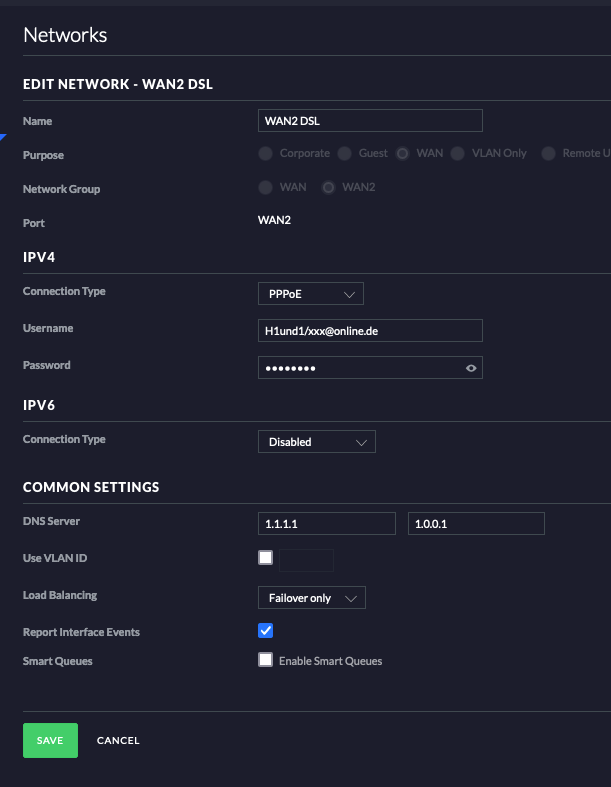

The usg can connect via pppoe with the modem as is, on the same credentials:

After a lot more digging, I’m thinking this is not my fault but a bug. It seems like “received PADO with unknown host-uniq, dropping” is an issue that kept coming up on different ROS versions since at least 2010, cannot find a solution anywhere. I really didn’t expect the rb5009 to be incapable of something the ui device could do… :confused:

I don’t think this message indicates an issue at all, but is instead a red herring. I would guess that else is trying to authenticate with PPPoE at the same time that your router is, and your router receives the PADO packet meant for the other person’s router, and drops it because it doesn’t match the host-uniq for your router - which it should do. If the offer is not meant for your router, your router should not accept it. You get up to the PADS stage and then the LCP ConfReq’s go unanswered. I agree with anav that you should talk to your ISP and see if they have somehow restricted it to only the MAC of your Ubiquiti router.
When I set the Draytek without bridge mode, it connects without problems. So I’m thinking it cannot be a restriction to the Ubiquiti MAC? Also that would be very unusual as the ISP expects me to use the supplied fritzbox router. Back when I installed the second ISP, it took me a bit of negotiation for them to even activate dual stack as the Ubiquiti doesn’t handle ds-lite. Their support hotline will not be of any help, people with zero technical knowledge working of flow charts that end with: No fritzbox → not our problem. Even if the issue is on their side, I will have to identify it with absolute certainty before I contact them.

I did sniff the ether1 yesterday but I honestly have no clue what to look for. It seems like when the mikrotik is sending a host-uniq, the other end is always responding with the same number. I’m not sure if it would be helpful and/or a good idea to upload the sniffer file here?
