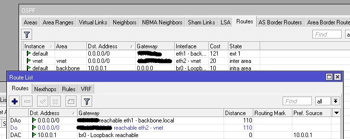

I did some more testing, and never mind, the issue still persists.
As soon as I take down the datacenter OSPF instance, and then bring it back up, the old default route is still stuck in the routing table.
You can see in the screenshot that the route with distance 121 is installed in the routing table as the default route, altho there is a better route with distance 20, that is blue in the routing table, and not used.
I am very unhappy now…

what you show is a default route in instance VNET and a default route in instance DEFAULT
may be coming from this
a+
Thierry
Yes, we peer with datacenter in a separate OSPF istsance, and then have our own internal OSPF instance.
Both instances redistribute a default route, for redundancy in case something fails.
But as you can see, the default route from the wrong instance gets stuck in the routing table when its supposed to go away.
This of course happends only if the datacenter link goes down and then back up.
you have two routes from different OSPF instances installed in the routing table, both with the same distance. the choice is ‘random’, as far as I remember from docs. you may use routing filters to decrease distance of your preferred default route
They dont have the same distance. One is distance 20, the other 121 in OSPF Routes.
They get installed in the routing table with distance 110, because that is default for OSPF routes.

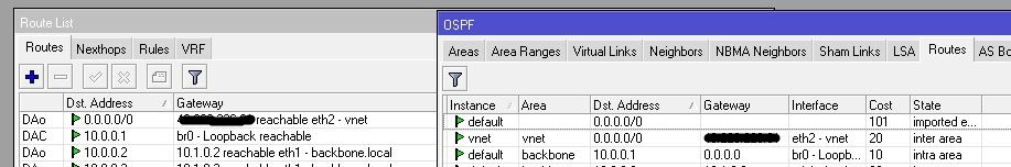

Here is the exactly same router, all I did was reboot it:
