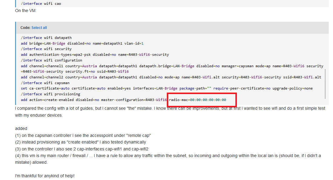

On the VM:
# 2024-06-11 15:48:56 by RouterOS 7.15
# software id =
/interface wifi
add name=cap-wifi1 radio-mac=D4:01:C3:94:99:A2
add name=cap-wifi2 radio-mac=D4:01:C3:94:99:A1
/interface wifi channel
add band=5ghz-n disabled=no frequency=2300-7300 name=channel1 skip-dfs-channels=all width=20mhz
add band=2ghz-n disabled=no frequency=2300-7300 name=channel2 skip-dfs-channels=all width=20mhz
/interface wifi datapath
add bridge=LAN-Bridge disabled=no name=datapath1 vlan-id=1
/interface wifi security
add authentication-types=wpa2-psk disabled=no name=R403-Wifi6-security
/interface wifi configuration
add channel=channel1 country=Austria datapath=datapath1 datapath.bridge=LAN-Bridge disabled=no manager=capsman mode=ap name=R403-Wifi6 security=R403-Wifi6-security security.ft=no ssid=R403-Wifi6
add channel=channel2 country=Austria datapath=datapath1 disabled=no mode=ap name=R403-Wifi.alt security=R403-Wifi6-security ssid=R403-Wifi.alt
/interface wifi capsman
set ca-certificate=auto certificate=auto enabled=yes interfaces=LAN-Bridge package-path="" require-peer-certificate=no upgrade-policy=none
/interface wifi provisioning
add action=create-enabled disabled=no master-configuration=R403-Wifi6 radio-mac=00:00:00:00:00:00
I compared the config with a lot of guides, but I cannot see “the” mistake. I know there can be improvements, but at first I wanted to see wifi and do a first simple test with my enduser devices.

(1) on the capsman controller I see the accesspoint under “remote cap”
(2) instead provisioning as “create enabled” I also tested dynamically
(3) on the controller I also see 2 cap-interfaces cap-wifi1 and cap-wifi2
(4) this vm is my main router / firewall / … I have a rule to allow any traffic within the subnet, so incoming and outgoing within the local lan is (should be, if I didn’t a mistake) allowed.
I’m thankful for anykind of help!

Can you please do a standard export instead of verbose?
done. Checked the config in winbox, seems identical, but the accesspoints didn't see capsman anymore.
Played around with the interface, and at some point the accesspoint changed to "managed by capsman". But there's still no wifi.

Did you do this manually on the CAPsMAN?
/interface wifi
no.
Those are the 2 mac adresses from the first cAP ax... in the gui they appeared after the ap sees the capsman...
Try to remove radio-mac
radio-mac (MAC address) MAC address of radio to be matched. No default value.
//EDIT: I understand, you took that info from the original configuration, which I replaced with the suggested simple one. In the current config is no 00:…00 anymore. It’s empty.

add action=create-dynamic-enabled master-configuration=config supported-bands=\
    5ghz-n
[admin@VM-Router-R403] /interface/wifi/provisioning>
same issue here as with TO - tried your solution with removing mac but no luck still

nothing new, I used that source of knowledge as well.
Still I have “SSID not set” in both wifis
