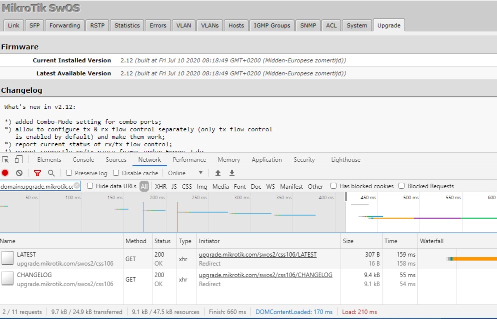

Check for System Upgrade - and that, for me always works…
I admit the “upgrade” check puzzled me too. (Maybe the switch had router discovery methods ?)
But as you stated it , I started having a little check.
There is no IP session originating from the switch at my edge gateway/firewall. (There should have been an open NAT session)
So where does it come from ? There is traffic from my PC. So let’s check the browser page. (Chrome has the developers tools built in).
And the browser is checking upgrade.microsoft .com to fill in this page. The switch is not initiating a request.
Ain’t that interesting…
