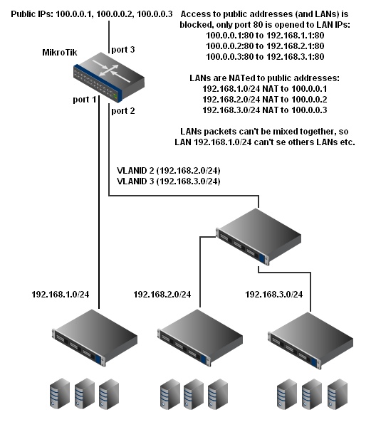

Hello all, I need help with MikroTik setting. I found lot of examples on Internet, but not little more complex one. I hope this example can help useful for more people.
Please see attached illustration for quick access. If someone can be so willing and explains complete setting script for this example I will be happy.
I have subnet of public addresses. In this example I choose three addresses (PUB1) 100.0.0.1, (PUB2) 100.0.0.2 and (PUB3) 100.0.0.3 (all others PUBs are similar to on of this three). Internet is connected to MikroTik (MT) to port 3. Next I have three LAN subnets (LAN1) 192.168.1.0/24, (LAN2) 192.168.2.0/24 and (LAN3) 192.168.3.0/24. Theese LAN subnets cant be mixed together with any packet. LAN1 is connected to MT port 1. LAN2 and LAN3 are connected to switch and encapsuled to VLANs, LAN2 to VLANID2, LAN3 to VLANID3 and VLANs are trunked to MT to port 2.
What I need. I need do NAT of LANs to PUBs, LAN1 to PUB1, LAN2 to PUB2, LAN3 to PUB3. Public addresses must be blocked from incoming traffic, only port 80 can be forwared to LANs IPs X.X.X.1:80, this means PUB1:80 to 192.168.1.1:80, PUB2:80 to 192.168.2.1:80, PUB3:80 to 192.168.3.1:80.

You can apply multiple IP addresses to an interface, and in this case should. It’s simple and works. You can fake it out with proxy ARP, but I personally think that’s messy. If you have a lot of IPs to add you can always script that out and have as many IPs as you want added with just a few lines of code in a for loop.
Overload public IPs on the WAN interface:
add address=100.0.0.1/24 interface=ether3
add address=100.0.0.2/24 interface=ether3
add address=100.0.0.3/24 interface=ether3
In the firewall, permit tcp/80 inbound and block traffic between internal networks. This is not an exhaustive rule set, for example it does not protect the router itself:
add chain=forward connection-state=established action=accept
add chain=forward connection-state=related action=accept
add chain=forward connection-state=invalid action=drop
add chain=forward in-interface=ether3 protocol=tcp dst-port=80 action=accept
add chain=forward out-interface=ether3 action=accept
add chain=forward action=drop
Forward tcp/80 to the relevant web servers:
add chain=dstnat in-interface=ether3 dst-address=100.0.0.1 protocol=tcp dst-port=80 action=dst-nat to-address=192.168.1.1
add chain=dstnat in-interface=ether3 dst-address=100.0.0.2 protocol=tcp dst-port=80 action=dst-nat to-address=192.168.1.2
add chain=dstnat in-interface=ether3 dst-address=100.0.0.3 protocol=tcp dst-port=80 action=dst-nat to-address=192.168.1.3
And PAT the internal networks as required:
add chain=srcnat out-interface=ether3 src-address=192.168.1.0/24 action=src-nat to-address=100.0.0.1
add chain=srcnat out-interface=ether3 src-address=192.168.1.0/24 action=src-nat to-address=100.0.0.2
add chain=srcnat out-interface=ether3 src-address=192.168.1.0/24 action=src-nat to-address=100.0.0.3
There you go. The manual wiki pages on firewall filters and NAT go into detail on what the options do.
Fewi, thank you for explain the basic settings. What about VLAN implementation? I think some /interface vlan setting is missing…
Yes, I didn’t show that as I didn’t realize you needed that information. It’s pretty simple and straight out of the manual.
First you create two VLAN interfaces tied to port 2:
/interface vlan
add name=vlan10 interface=ether2 vlan-id=10
add name=vlan20 interface=ether2 vlan-id=20
Now you treat the VLAN interfaces just like you’d treat a physical interface:
add address=192.168.1.1/24 interface=ether1
add address=192.168.2.1/24 interface=vlan10
add address=192.168.3.1/24 interface=vlan20
