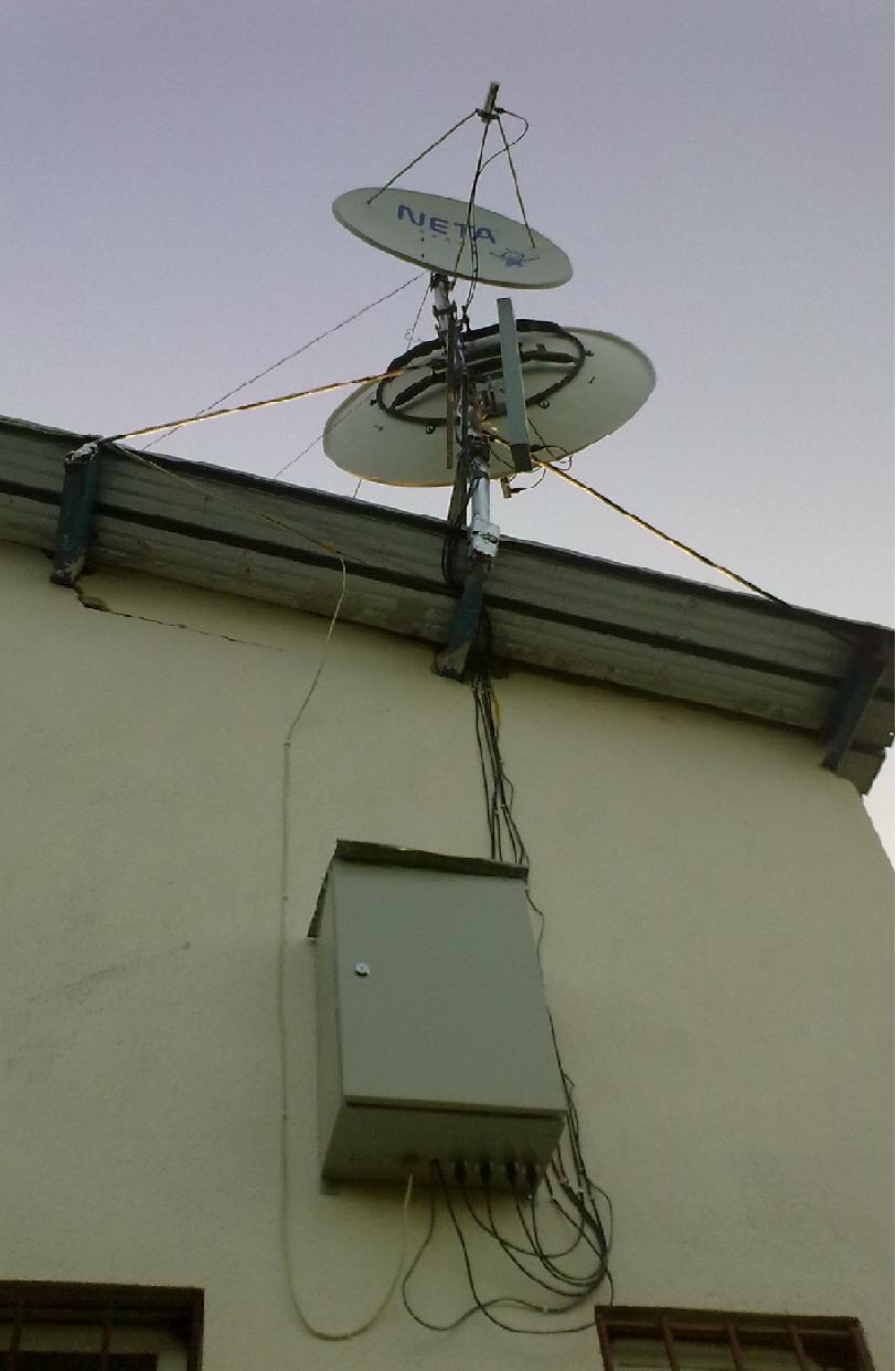

A-1km-B-14km-C-34km-D
A-have no image

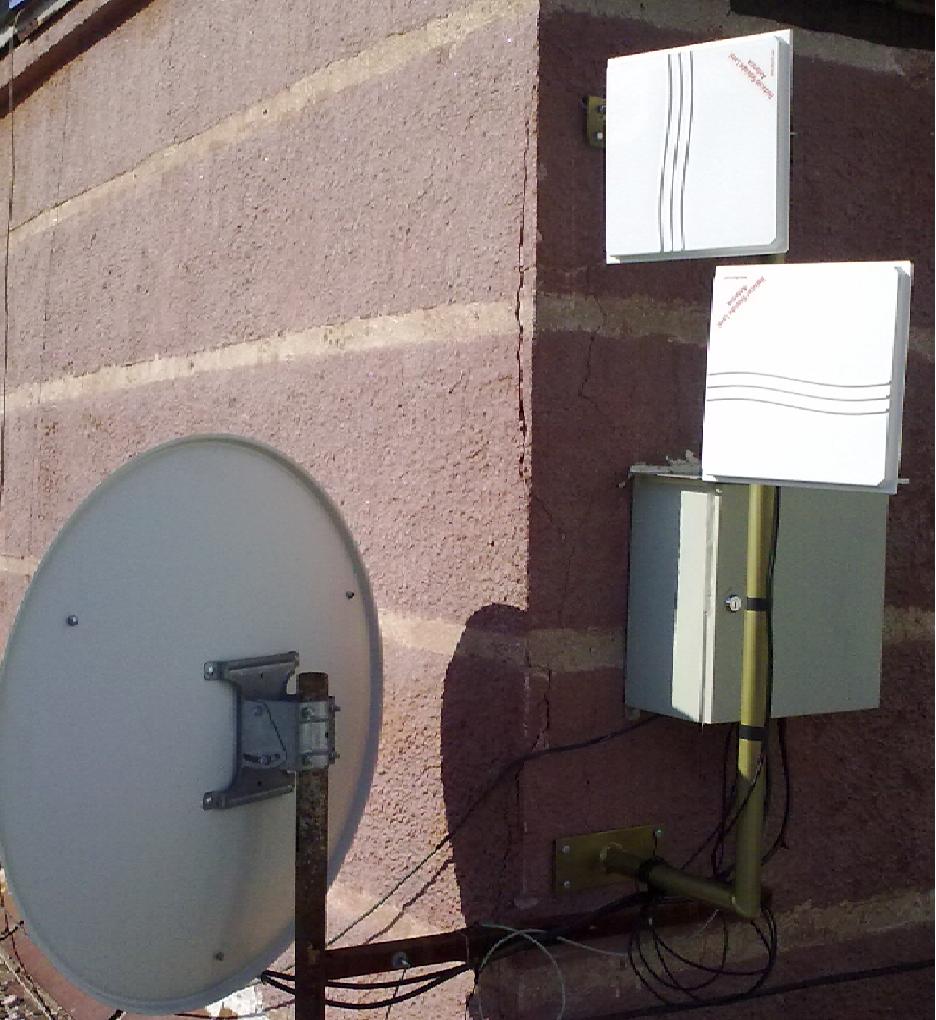

This is on point B
2x2 Panels 2x2 UB5
Dual Polarization Dish B–>C
This is on Point C
2x2 Dual Polarization Dish

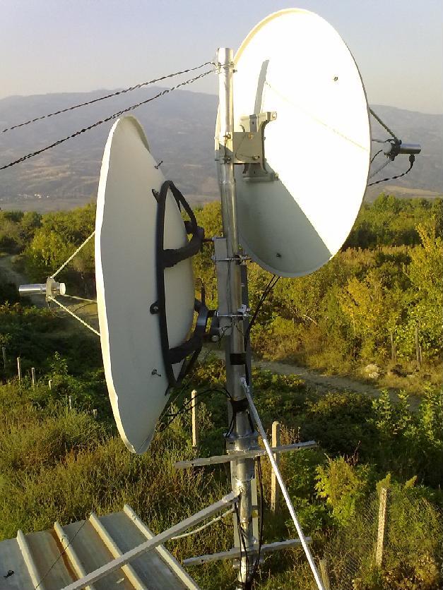

A-have no image
This is on point B
2x2 Panels 2x2 UB5
This is on Point C

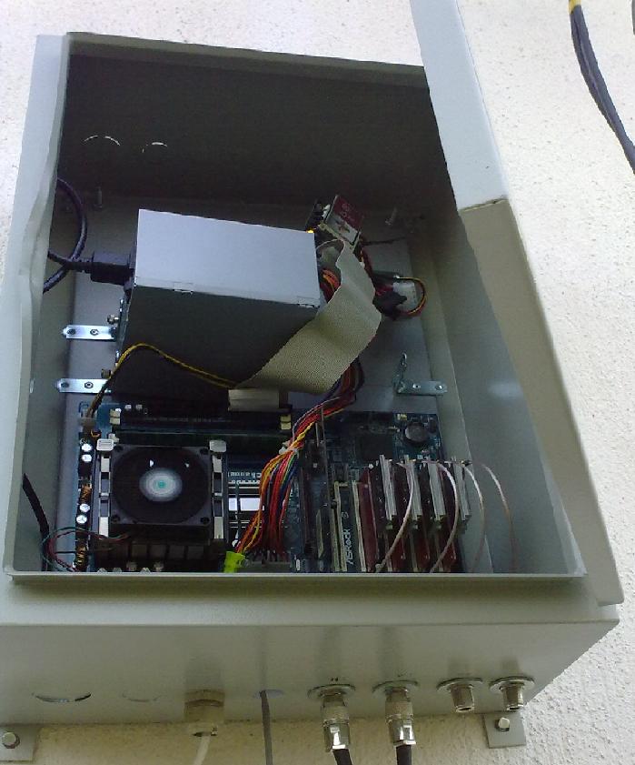

Antenna with dual converter
From The Ground
Inside the Box 4xXR5 Intel 2400Mhz - If u want call me crazy

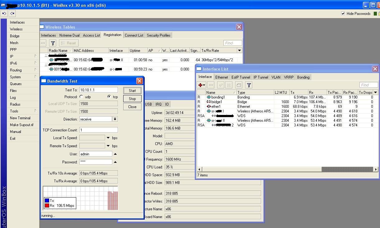

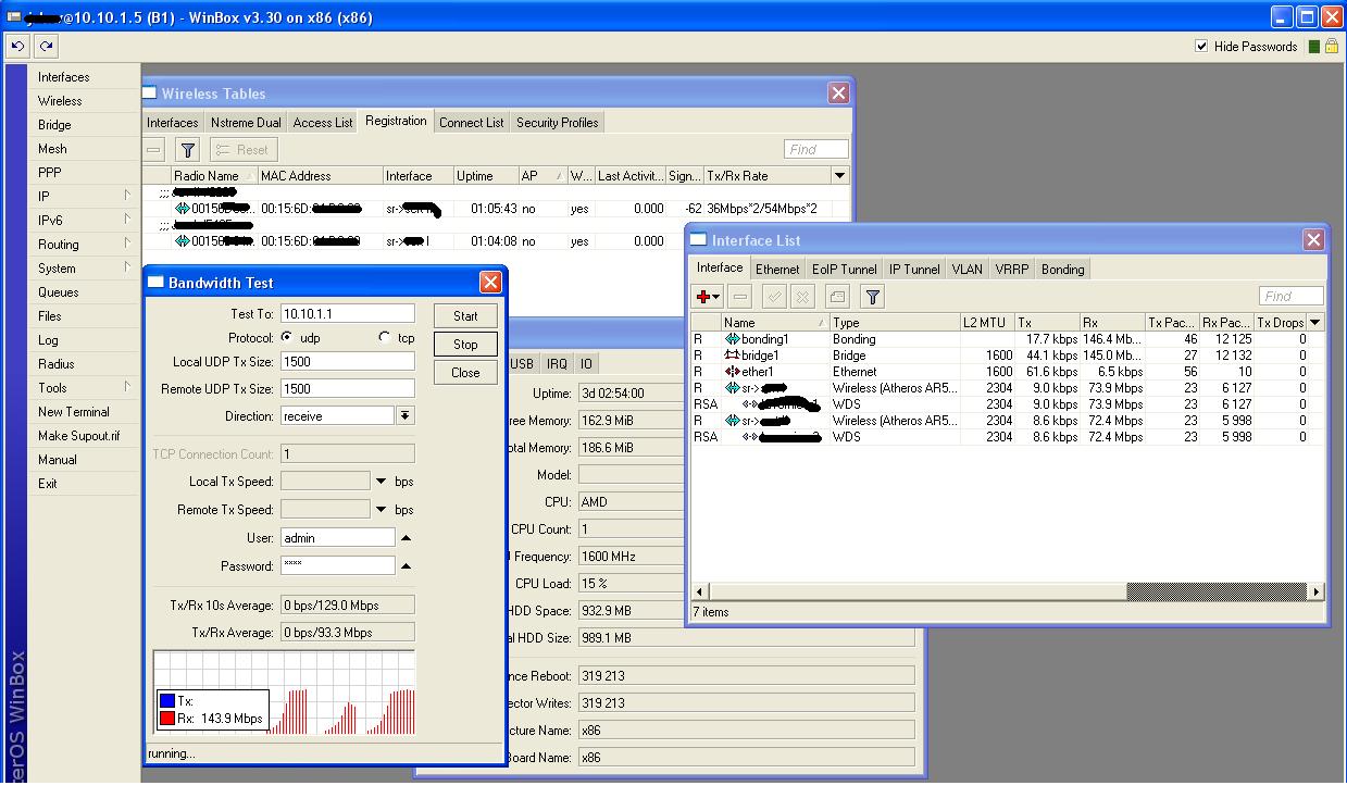

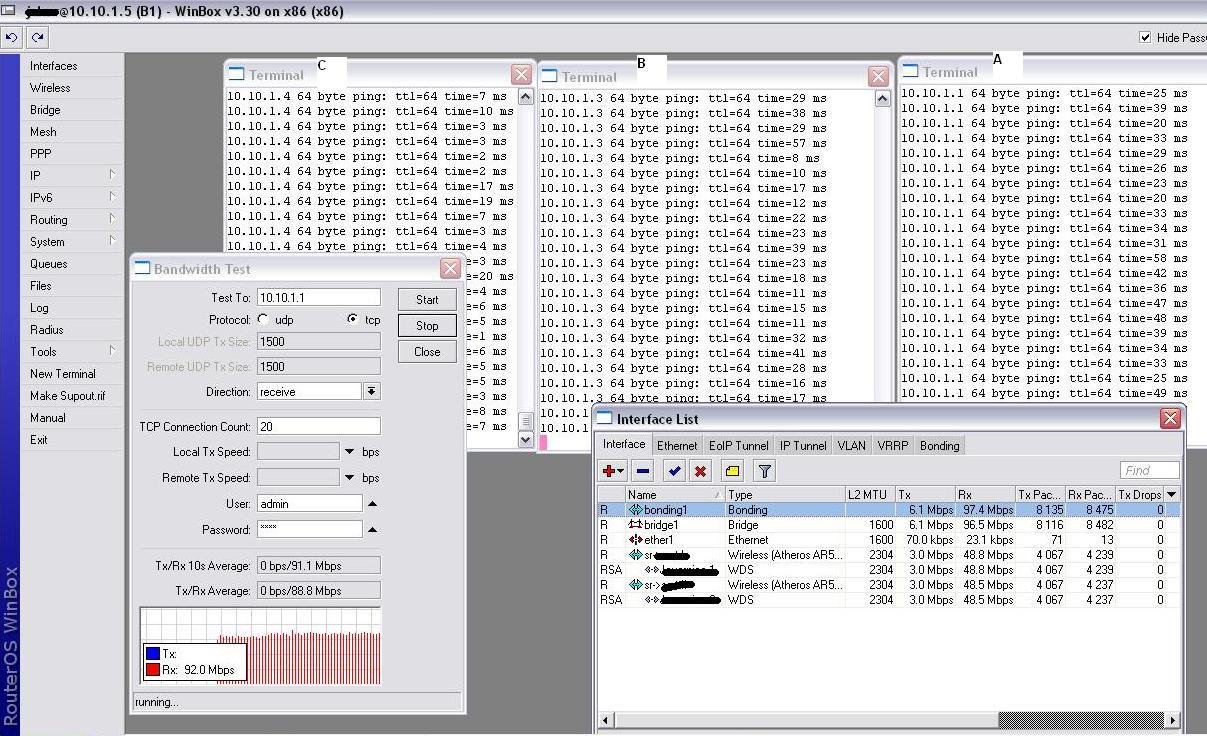

Back To the test
10.10.1.5 Point D
10.10.1.1 Point A
TCP
UDP
On heavy traffic link is about 90-95 Mbit
I really want to know if I implement N can get more speed ?
On forum I can see n can go up to 80mbit TCP 200Mbit UDP

I want to rid off from pc’s but I can’t find any RB with a lot of Horse Power that can Handle 4xXR5.

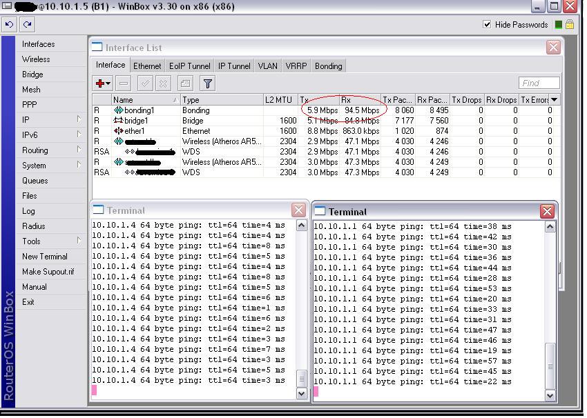

Can you try and post your ping times?
A->B
B->C
C->D
A->D
And was the bandwidth test from D->A?
Yes I also think the link was perfect but I run in some problems with interference between wlan’s
When TCP traffic From D->A was about 100-105 or when the traffic was about Rx50Mbit/Tx15Mbit On Point B and C TX/RX Rate will fall to Tx54Mbit/RX18Mbit or TX48/RX12M or 48/6 etc… - than the throughput from A->D was disaster (2-4%Packed lost). Sometimes Ping just jump from 3-5 to 30-40 (than throughput was 40Mbit ) Than I have to disable/enable wlan’s , change channel (10Mhz up/down) All problems were between Point B and C - 4xWlans on B/C

New TCP Test A->D
I have a lower data rate but the link is much more stable (2 days with no problems)

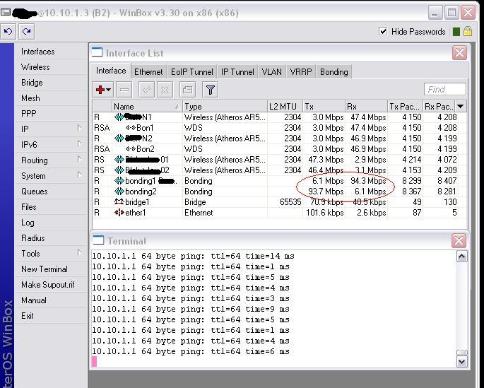

Now problem is between Point B<->C like I said I change 4xXR5 (600mW) with 4xUB5(200mW)
signals were -57/-60 now with UB5 signals are -65/-67 Tx/Rx rate is 36mbit/36Mbit–48mbit/36mbit so the throughput is
B<-90 up to 95Mbit->C
I think I can fix it with bigger dishes I hope I’ll get better signals like -60 and >105mbit but 90mbit is fine for now.

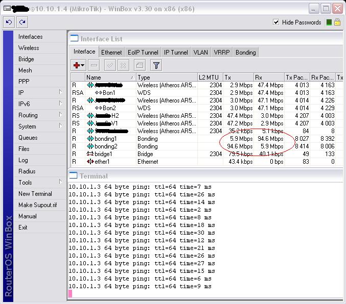

QpoX This is TCP test from A->D
A-10.10.1.1
B-10.10.1.3
C-10.10.1.4
D-10.10.1.5
Point D
Point C
Point B
I hope this is what u looking for..

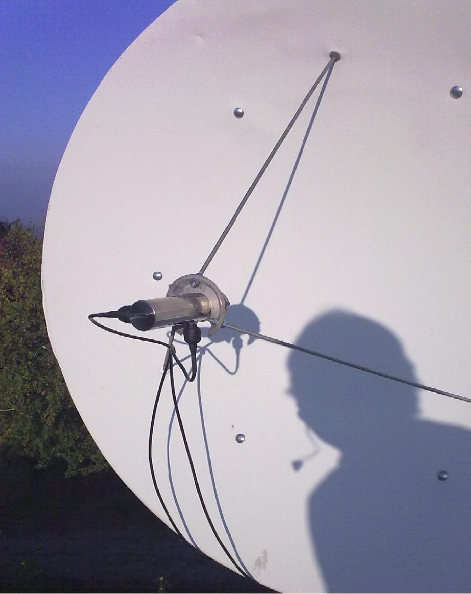

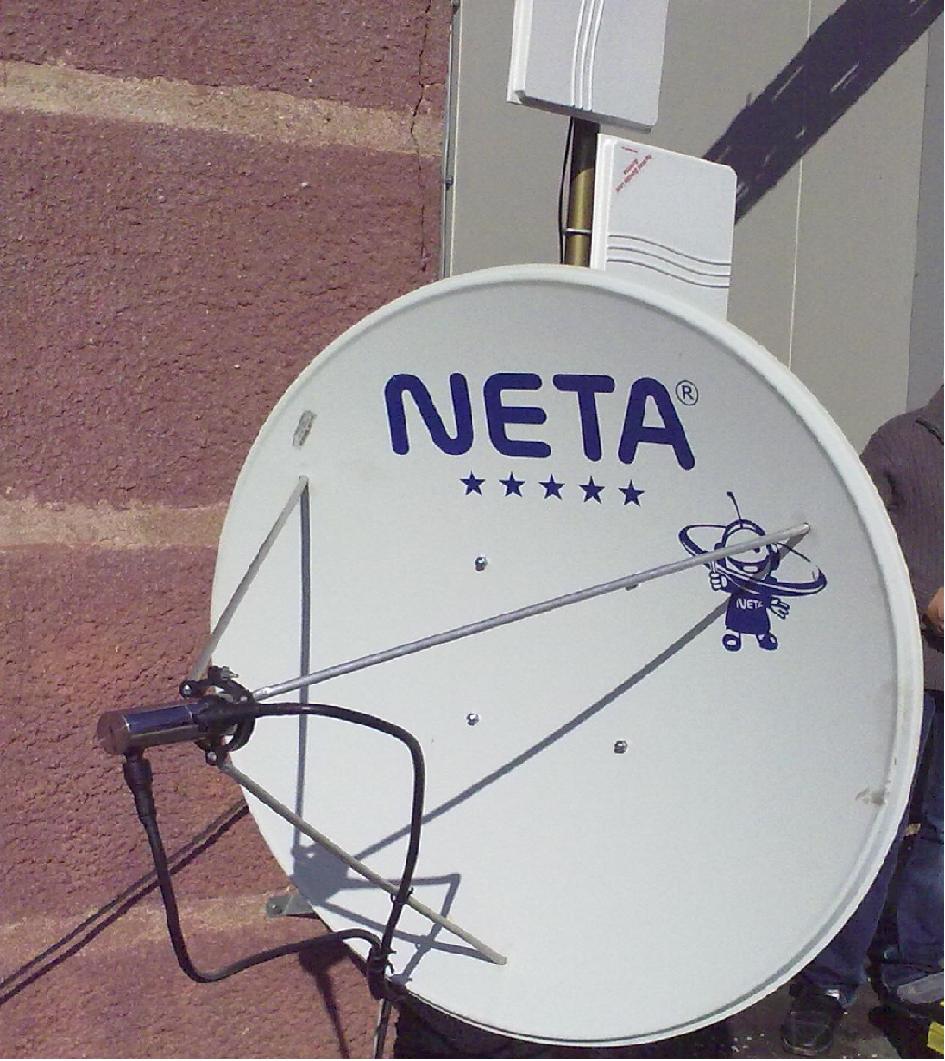

can you post a drawing of the lmbs on your dishes with the dimentions on so i can see how close my lmbs are
as i have had no luck with dual lmbs
thansk for the help
As u can see up on the post on Neta-Dish lmbs are about 0.65-0.75m from the dish
On the biggest dish on point C lmb-horn is about 0.4-0.5m But I m not sure I’ll make new pic. I’ll post them tomorrow
I use this limbs - @irLAN 5000 - DP (one is 130$+shipping)
http://videomaxavs.com/en/store/Scripts/prodView_short.asp?idProduct=188897
Are you sure? You have an AMD cpu ![]()

magnavox yes its Intel 2400Mhz Mb Asrock Prescott 82801 Intel chipset

On 3 Point dish is about 1.2-1.3m (not shure dish is old never measured) @irLAN 5000 - DP lmb (should be 32db)
On the last point dish is (Like pick.. up on the post Neta-Dish) 90sm (should be 28-29db)
Strange… RouterOS show AMD in your resource TAB ![]()
hoho yes there it is
there are 4 pc’s 2 AMD 2 Intel (what does it meter I use what I can find)
