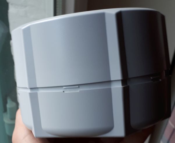

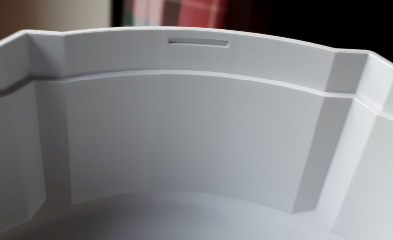

Sure, you’ll need to use plastic tool to stick it between the parts.
Top (part towards antenna) fits over bottom (part with sim/network interface). You’ll need to apply some pressure on the bottom part in each of the 6 sections of the hexagon to release internal latch and pull the top apart.
Together:
Top:
Cheers sebastia,
Just popped it open there, all good.
